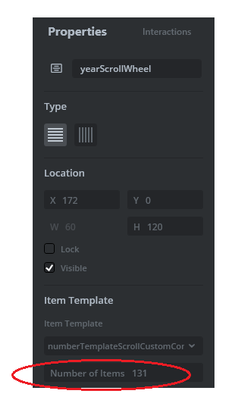

Yes, add these function definitions to DatePICKER.hpp under public items:
void setDay(int16_t day) // day 1-31
if(day>=1&&day<=31)
numberDateScrollWheel.animateToItem(day-1, 0); // 0= first day in wheel so decrease 1
void setYear(int16_t year) // year 1900 -
if(year>=1900&&year<(yearScrollWheel.getNumberOfItems()+1900))
yearScrollWheel.animateToItem( year-1900, 0); // 1900 is first in wheel so decrease 1900
void setMonth(int16_t month) // month 1-12
if(month>=1&&month<=12)
monthScrollWheel.animateToItem(month-1, 0); // 0= january in wheel so decrease 1
It should do pretty much what you need :D
You can also add number of items of yearScrollWhell to get current year + some extra availabe

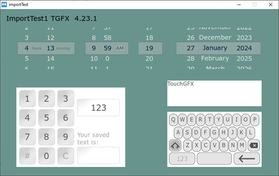

Hello
This importing function is bit problematic. See attached widgets, I've update those that there is no duplicate resources any more. Made and tested with version 4.21.4.
Seems that 4.22.0 and later version has bug in importing function. Those cant handle even same font, but importing crashes if you have same font allready used on the project you are importing to.These example widgets uses Verdana- font.
There seems to be workaround so that select first some other font than verdana to all existing typographies of your project. Then delete the font file verdana.ttf from \assets\fonts\ folder and then import one widget. Repeat, if need to import another widget. When finished importing, restore the font selections if needed.
Please note that if you try to import to widgets with same/used font, even that importing is not finished, it imports something since the preliminary inspection doesn't find any problem and after this importing same widget will fail on the pre-check.
Same problem occurs even if widget is made and exported from 4.23.0.
Br JTP
2024-01-27 1:04 AM - edited 2024-01-27 1:05 AM
Hello
Confirming that import font bug seems to be fixed in the 4.23.1 version.
Now its possible to even import all example containers to same project when using picker widgets from the post above.
Please share if someone has new ideas or needs for example containers !
Br JTP

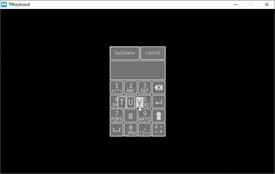

2024-03-15 9:53 AM - edited 2024-04-19 6:29 AM
Please find attached a new custom widget (tpkg file and pdf instructions).
It a T9 keyboard. the old style of keyboards used on phones (not smartphones).
It is more compact and therefore it is suitable for small screen projects.
Regards,
2024-03-21 11:33 AM
Hello Gaetan
Nice work !
Perhaps cursor (just static vertical bar '|'.. or even blinking) would be useful addition. Now when press space, you cannot see that in the text area.
Br JTP

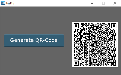

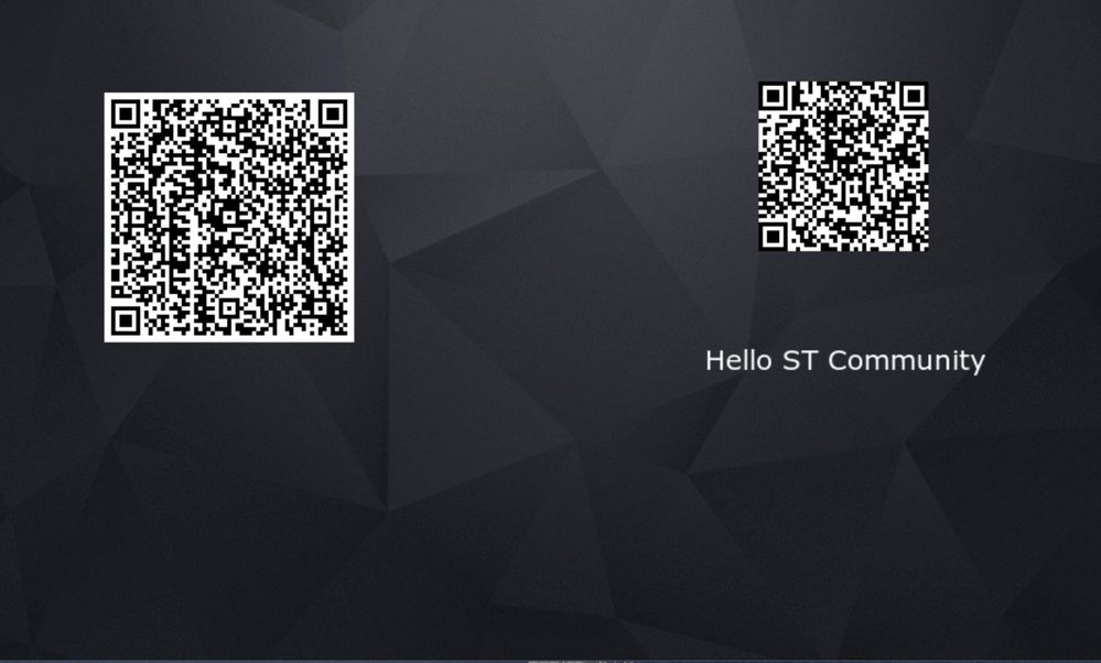

Hello wonderful community,
I'm glad to share a custom QR Code widget with you that you can use to create a QR Code either from text provided in the code or text from a Text Area in the designer.
It is worth mentioning that the size of the QR Code symbol depends on the version you choose (from 1 to 40, you can read more about the different sizes here ) and the scale (i.e. multiply factor).
QRCode widget

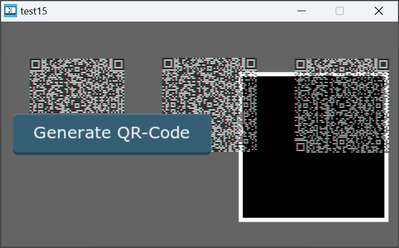

Can you please give an example or documentation? I imported your widget in an empty project and I put in a single container in a screen (also added a button and a background). I get 3 QR codes in the background. I did not write a single line of code, this is the default behavior of your widget.
2024-04-04 10:17 AM
Hello array
Seems that your project is having 24 bit colors and as default, this widget uses 16 bit color.
So browse to the \test15\TouchGFX\gui\include\gui\widgets\ folder and open 'QRCodeWidget.hpp' file. There comment 16 bit define and uncomment 24bit define. Like this
//Uncomment based on the selected display bpp (Bit per Pixel)
//#define QR_WIDGET_USE_8BIT_COLOR 1
//#define QR_WIDGET_USE_16BIT_COLOR 1
#define QR_WIDGET_USE_24BIT_COLOR 1then it works:
Hope this helps.
Br JTP
