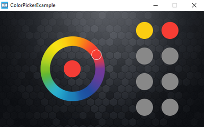

We made a color picker widget with an example and some documentation!
You can get the currently selected color on the wheel as a touchgfx::colortype format that can directly be used in your widgets (box and others).
Enjoy!

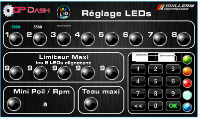

I'm trying to use your keypad. In my screen I added the keypad container. The circles 1, 2, 3 ... will be buttons.
If I select button 3 for example, I would like the value of savedTextArea to appear in the screen above button 3 and not in the keypad container. It would also be necessary for it to become a variable linked to button 3 that I could later save on an eeprom. Same for each button.
I tried several things but I can't do it. Could someone give me an idea, a piece of code to move forward?
2024-08-13 6:45 AM
up please
