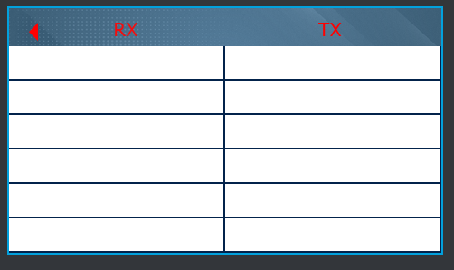

Thank you for your reply. I don't need to select any item, however I need to fill the table with incoming data from SPI/UART.
I have put a wildcard inside the scroll list container and this should store the received buffer - Do you know how to do that? It seems I need to do an infinite switch case function??
Also how do I make the table scroll up automatically as it gets filled?

I don't want to save any data, just want to display them on an infinitely long table. The data received from SPI comes in at around more than 10,000 per second, I want to display all of them if possible on the table.
I was successful yesterday at displaying random chars in the table but I have yet to figure out how to export SPI data to the table and make the table scroll up automatically.
