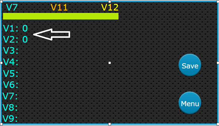

here is an example. I am using multiple text area widgets. There is a static text area for each measurement result (V1, V2..etc) and then a wildcard buffer for each of them. There are more results I would like to display than I can get fit on the display. Therefore I thought a scrollable container would be good, but I don't know how to implement that with wildcard values. I know how to do that with static text or normally with wildcard values when everything fits on the screen. I can make the font size smaller, but you can only do that for a certain point and it's not a good solution.

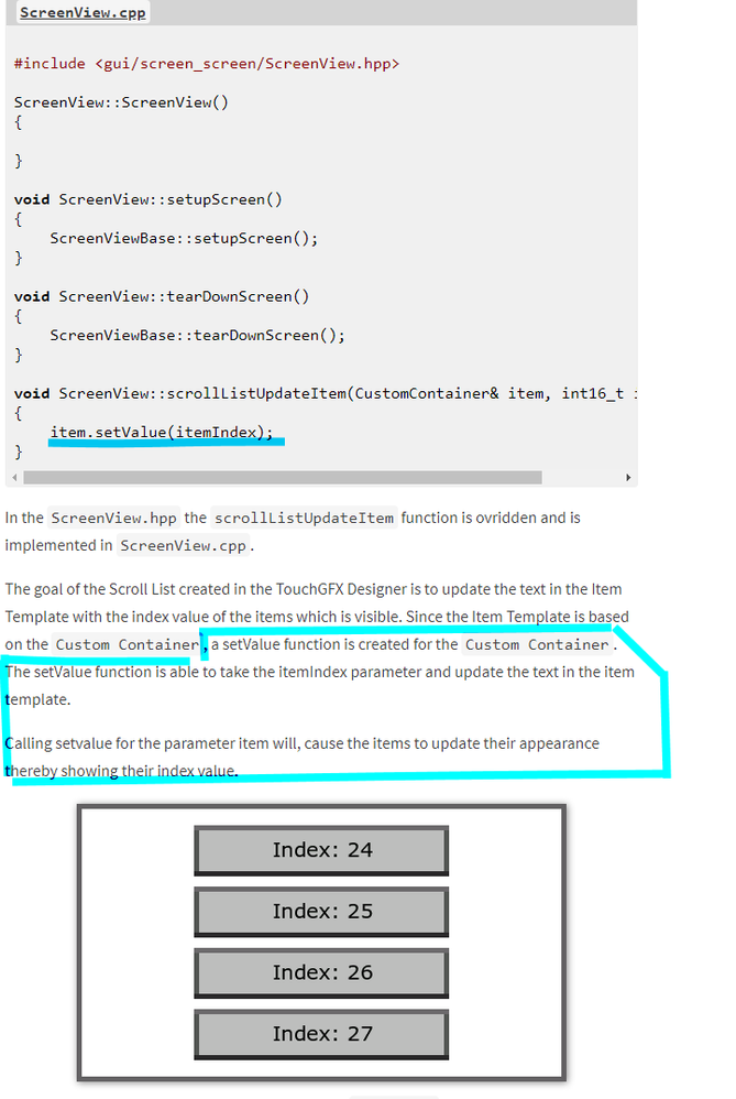

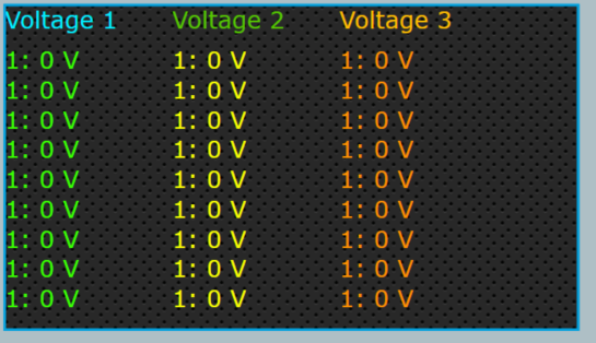

I looked at the scrollWheel tutorial. I think I would rather need to use the scrollList widget. Could you give me a pointer or a few how should I do that? I have 3 series of measurement results that I want to display. I would like that the all those 1s would be running index numbers and results (those 0s on that picture) wildcard values. Now they are in 3 separate scrollLists, but it would be best if they were in one. Is that possible since the text area seems to have 2 wildcard values maximum? I can live without that if I can get this otherwise working. Thanks in advance!
Edit: Should think a bit before blurting all out. Figured out I can make a custom container with 3 text areas and each with 2 wildcard values...

I read the tutorial about the Scroll List widget and tried to implement that but have to admit again my lack of competence.
I tried to implement the setValue function but no success. I would need some help doing that since I'm getting errors.
