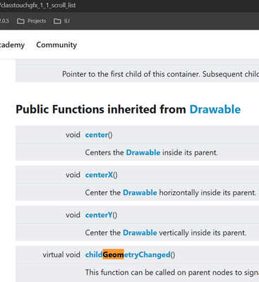

2025-04-29 7:22 AM
The scrollList inherit from drawable which have the method childGeometryChanged :
Setting the drag speed to 0 indeed prevent any movement, that could be a workaround for you. :)
Have you tried to call childGeometryChanged() though?
