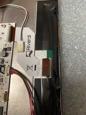

I am making this post because I just received a Riverdi STM32 Embedded display for my last ever studying project, as I will use it to replace 7-seg, buttons and keybord. I made a simple connection for the power supply (I soldered two wires on the connector, to avoid cutting the given cable, as I want to use it later in the final version of my project. My problem is that when I turn on the power, the screen switches on but only displays a black screen at maximum brightness. I tried reseting the device with the back button, and also created a simple TouchGFX project to display a png image and the memory flash of the microcontroller with ST-Link v2 works fine but once the flash is done, the screen goes back to the very bright black screen state.

Anyways I finally found my problem, which was about the fcp tape that connected the LCD screen. It is a bit short so it must have slipped out of the connector, but it was not visible when I turned the screen to see the PCB, as it was right next to where it was supposed to be.
So thanks for your time trying answering my problem, but it was only an hardware issue !
Here is the tape that caused the disfunctioning for anyone passing by this thread :)
