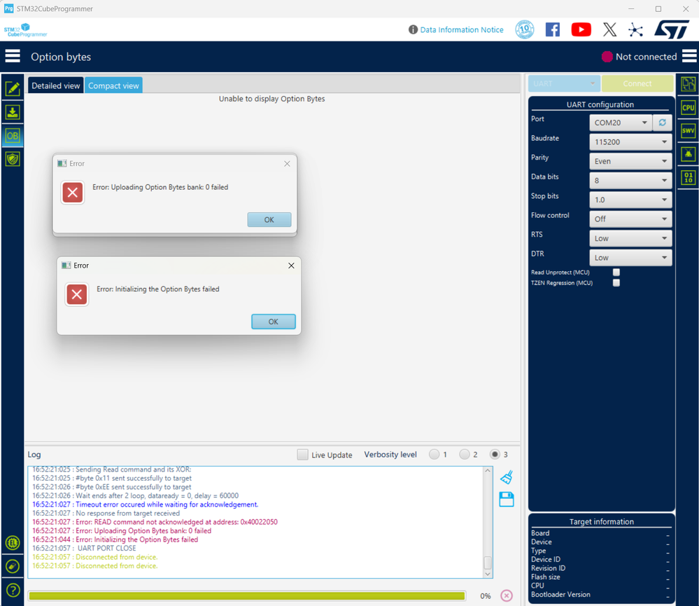

STM32H563: CubeProgrammer UART connect fails in PRODUCT_STATE = iROTProvisioned
JesperEC
Associate III
STM32H563 chiprev Z.
I am trying to work through How to start with OEMiRoT on STM32H573 and 563–Arm® TrustZone® enabled - stm32mcu using a NUCLEO-H563ZI MR1 board but using the latest STM32CubeProgrammer (2.18.0) and ST32Cube_FW_H5 (STM32Cube_FW_H5_V1.4.0).
Section 2.5 is intended to demonstrate booting securely and then dropping into the System flash bootloader from non-secure application and connecting to it via UART. In my case, I use the virtual COM-port provided by the ST-Link provided on the board. I have not dared to go all the way to CLOSED but have chosen to tell the provisioning.sh that I want PROVISIONED state. I have confirmed using the SWD-connection that the TZEN is enabled after this and that PRODUCT_STATE is iROTProvisioned.
I type 1 in the terminal displaying the "UI" of the non-secure app and then disconnect TeraTerm and in ST32CubeProgrammer I select connect method UART and Port = COM20, Baudrate = 115200, Parity = Even, Data bits = 8, Stop
bits = 1.0, Flow control = Off, RTS = Low, DTR = Low. Except for the COM-port-number these are the default settings.
When I click Connect the application talks to MCU and from the log I can see that a number of GetID commands succeeds and then it issues (to my understanding) some Read Memory commands and then does GetID again and now this command times out. After a while it will fail popping 3 dialog boxes with texts
"Error: Initializing the Option Bytes failed"
"Error: Uploading Option Bytes bank: 0 failed"
"Error: RDP is set to level 1 or target is held under reset, try using Read UnProtect (-rdu) command in order to remove the Read Out Protection"
and disconnects.

Log snippet:

16:52:21:009 : Error: RDP is set to level 1 or target is held under reset, try using Read UnProtect (-rdu) command in order to remove the Read Out Protection.
16:52:21:023 : UPLOADING OPTION BYTES DATA ...
16:52:21:023 : Bank : 0x00
16:52:21:023 : Address : 0x40022050
16:52:21:024 : Size : 176 Bytes
16:52:21:025 : Sending Read command and its XOR:
16:52:21:025 : #byte 0x11 sent successfully to target
16:52:21:026 : #byte 0xEE sent successfully to target
16:52:21:026 : Wait ends after 2 loop, dataready = 0, delay = 60000
16:52:21:027 : Timeout error occured while waiting for acknowledgement.
16:52:21:027 : No response from target received
16:52:21:027 : Error: READ command not acknowledged at address: 0x40022050
16:52:21:027 : Error: Uploading Option Bytes bank: 0 failed
16:52:21:044 : Error: Initializing the Option Bytes failed
16:52:21:057 : UART PORT CLOSE
16:52:21:057 : Disconnected from device.
