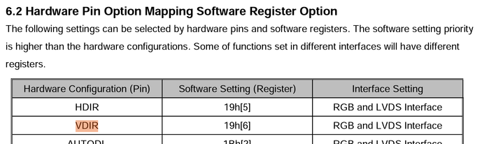

Show your display info and dont waste time with this theory. RGB dont define, that display skips internal memory, and some displays dont have internal memory and accept setups for rotation...
One example ST7262 800x480
