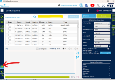

Hello @mcumake ,
Could you try to flash using STM32CubeProgrammer? The flash loader (.stldr) is inside the gcc folder of the project. You can copy that file to the External loader folder of your STM32CubeProgrammer (by default C:\Program Files\STMicroelectronics\STM32Cube\STM32CubeProgrammer\bin\ExternalLoader) and then use it for flashing your board.

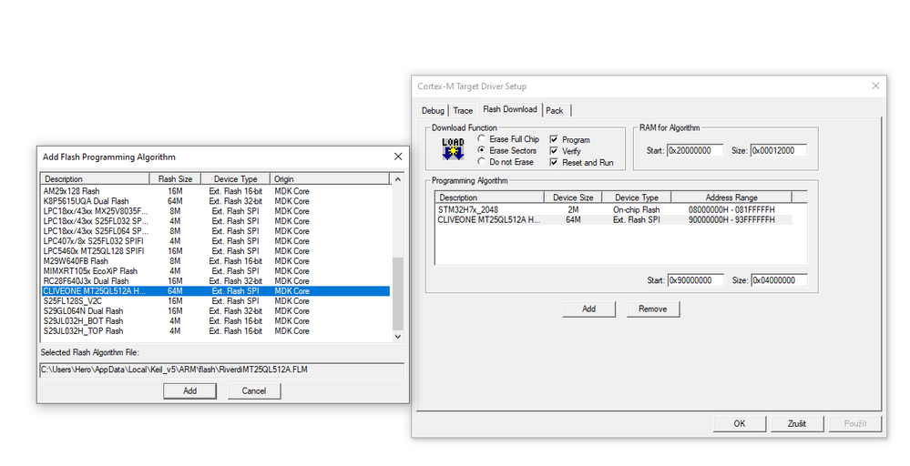

2025-10-09 5:48 AM
I found some external loader for Riverdi memory.
https://github.com/cturvey/stm32extldr/blob/main/h7_mt25ql512a/README.md
I'm going to try it.

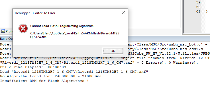

2025-10-09 7:58 AM
I tried a new FLM file for Riverdi but the process failed.
What is the correct setting for RAM ALGORITHM?

Ok, so complaining here about your code generated to be placed into 0x24000000 which is RAM. You need to check your Target setting for FLASH and RAM, ie the scatter file which is the equivalent to GNU Linker Script.
The .FLM is providing an Algorithm for the 0x90000000 address space, which is where the QSPI memory is situated.
