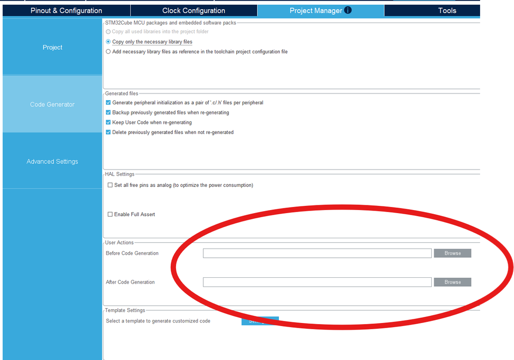

You can't expect CubeMX to handle you moving everything. Code generators expect certain folder structures.
One workaround is to add a script that moves main.c before code generation and moves it back afterwards:
Edit. Just tested it. Works great.
pregen.bat:
move main_path\main.c Core\Src\main.c
postgen.bat:
move Core\Src\main.c main_path\main.c
