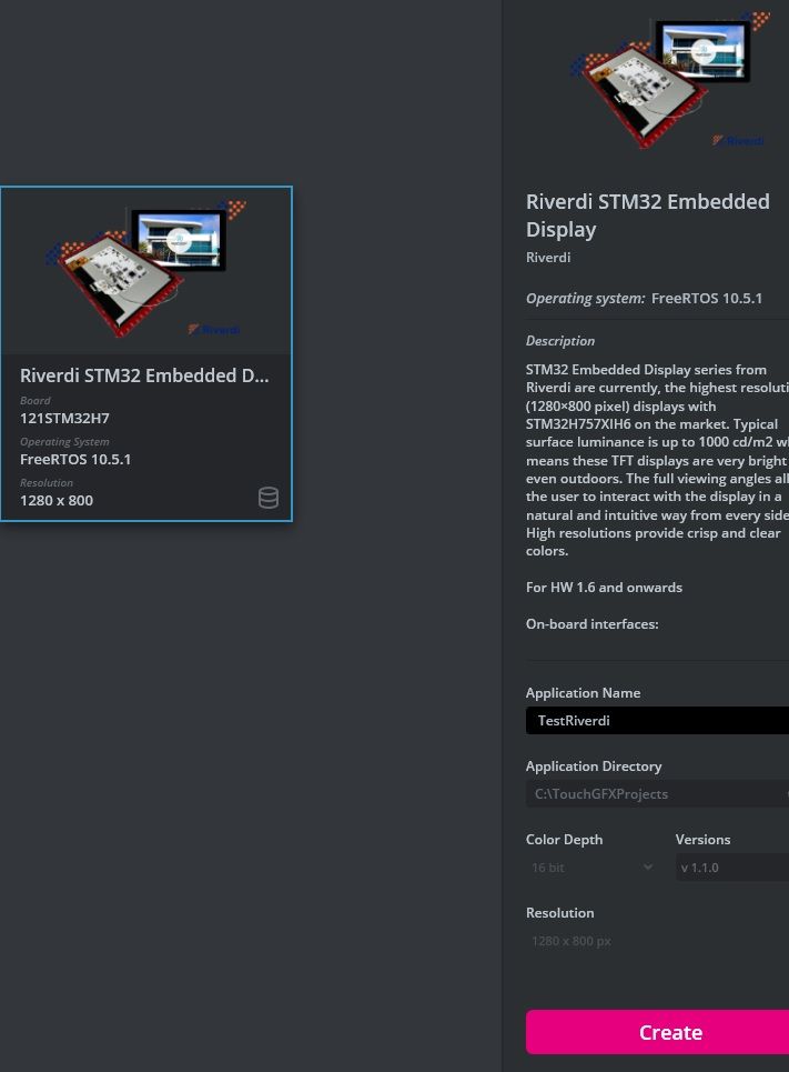

1/ Run TouchGFX Designer 4.25
2/ Create New project
3/ Go to tab – By Partners – select board Riverdi STM32 121STM32H7
4/ Click to Create

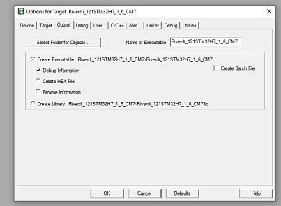

13/ Go to Option for target Go to tab OUTPUT
and uncheck Browse information

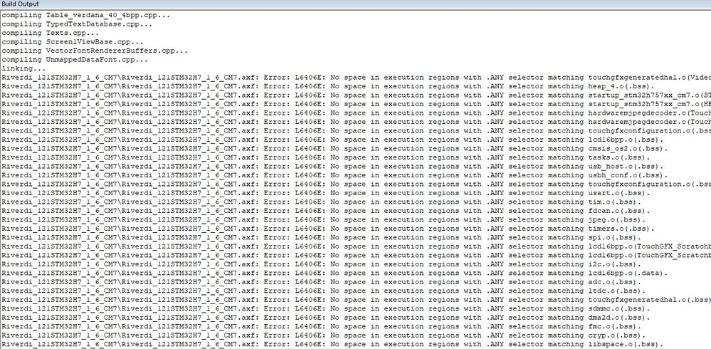

14/ Project build target
15 / Keil linking problem Not enough information to list image symbols.
Not enough information to list load addresses in the image map.
Finished: 2 information, 0 warning and 81 error messages.
"Riverdi_121STM32H7_1_6_CM7\Riverdi_121STM32H7_1_6_CM7.axf" - 81 Error(s), 0 Warning(s).
Target not created.
Build Time Elapsed: 00:00:14

2025-09-24 1:51 AM
linking...
Riverdi_121STM32H7_1_6_CM7\Riverdi_121STM32H7_1_6_CM7.axf: Error: L6218E: Undefined symbol ExitRun0Mode (referred from startup_stm32h757xx_cm7.o).
Finished: 2 information, 0 warning and 1 error messages.
"Riverdi_121STM32H7_1_6_CM7\Riverdi_121STM32H7_1_6_CM7.axf" - 1 Error(s), 0 Warning(s).
Target not created.

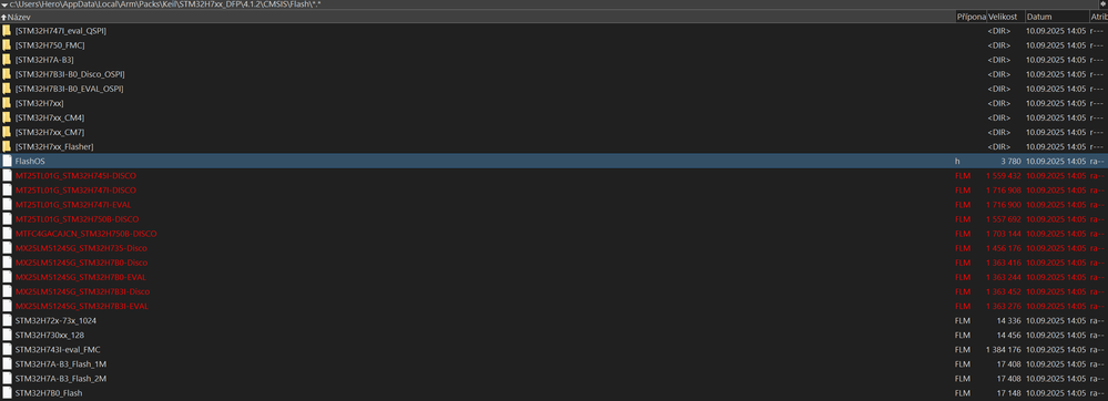

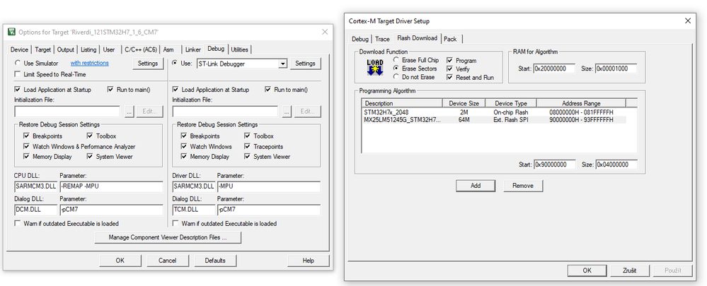

Hi Osman. Thank you very much for your help. Currently the compiler compiles the project without any problems.
But there is one more problem. The RIVERDI display uses external FLASH memory. I have a problem with the programming settings for this external memory. Keil only offers external flash memories from DISKO or EVAL boards.
How to create a programming file for the external flash of the RIVERDI board?
external flash memory for DISCO - EVAL boards

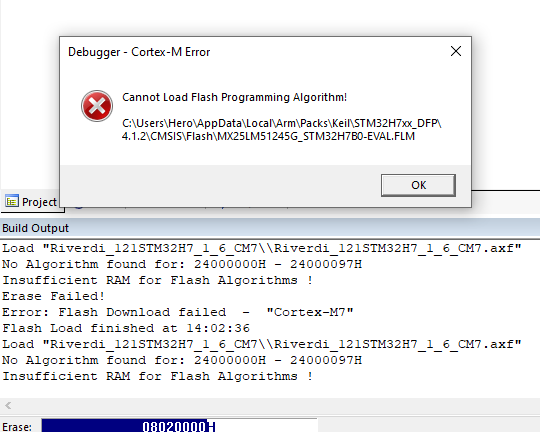

2025-10-08 5:09 AM
Hi.
I have tried all the presets for the 64MB external FLASH. The programming attempt always fails.
