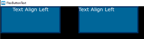

I have three buttons who's wild card text I change programatically. When I do so, the alignment of the text changes from centre-aligned to left-aligned.
Before:
After:

2025-04-18 8:19 AM
@ferro I ran your example in the simulator but every time I pressed the button the text was centered - did it behave differently for you? I even tried making the button the width of the screen to ensure I wasn't missing the movement.
2025-04-18 8:33 AM
"I pressed the button the text was centered"
Yes, that is what you wanted right ?
You said: "How do I change the alignment to centre-aligned programmatically?"
The example shows that the text is always centered regardles of the TypedText alignemnt.

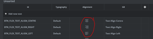

2025-04-18 8:38 AM - edited 2025-04-18 8:38 AM
With this code you are changing both text and alignment
buttonSelectThingA.setWildcardText(ThingANames[static_cast<int>(parameters.thingA)]);Whereas with my code you keep the alignment and change only text
Unicode::snprintf
flexButton1Buffer,
FLEXBUTTON1_SIZE,
"%s",
TypedText ( circular_next_ttid () ).getText()
2025-04-18 8:40 AM
So, what you need to do is this
Unicode::snprintf
flexButton1Buffer,
FLEXBUTTON1_SIZE,
"%s",
ThingANames[static_cast<int>(parameters.thingA)].getText()
