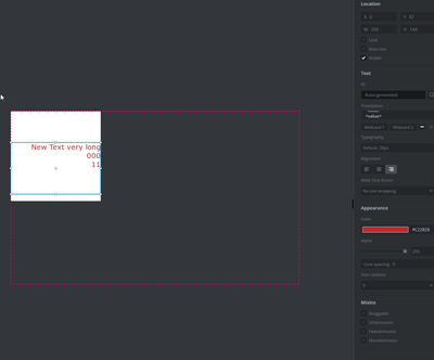

Aligning text to the right in a text area with wildcard doesn't work in a container. It always centers the text.
I print minutes and seconds.
It kind of looks like this (if the forum renders it correctly):
100:00
10:00
0:00
I've set the alignment to the right, but I don't see a difference with left or center alignment.
I tried upgrading to TouchGFX 4.24.0 but the problem persists.
How can this be?

2024-06-24 11:46 AM - edited 2024-06-28 6:37 AM
I created a new project from scratch in TouchGFX 4.24.0 and replicated the result. I used Arial and right align a field, but it clearly aligns left.
I think it's due to resizeToCurrentText. I think that doesn't take alignment into account. Resizing should move the left border of the text box, not the right border if it is right aligned.
I found the solution while typing this post: Using resizeToCurrentTextWithAlignment() instead solved the problem.

example code (executed every x ticks):
static int counter = 0;
counter = counter >= 10 ? counter/10 : 123456;
textArea2.invalidateContent();
Unicode::snprintf(textArea2Buffer, TEXTAREA2_SIZE, "a b %6d", counter);
bool typographySupportsFigureSpace = fontCharacterSupported(textArea2.getTypedText().getFont(), FIGURE_SPACE);
if (typographySupportsFigureSpace)
replaceSpacesBeforeDigitsWithFigureSpaces(textArea2Buffer);
textArea2.resizeToCurrentText();
The first character and the last digit now stay perfectly in place regardless of the number of digits and the values of the digits. This is exactly what I wanted.
EDIT: fixed bug, in simulator an exception would happen if isdigit() was called with non-ascii char
