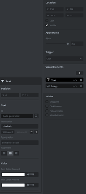

2025-04-16 2:57 PM
My button settings, should they be helpful in debugging:

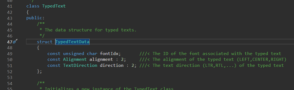

Maybe this ...
... will be available soon. At the moment the alignment is hardcoded - even the structure members are const.
\touchgfx\TypedText.hpp
\generated\texts\src\TypedTextDatabase.cpp

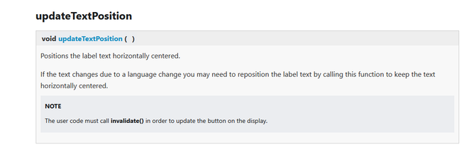

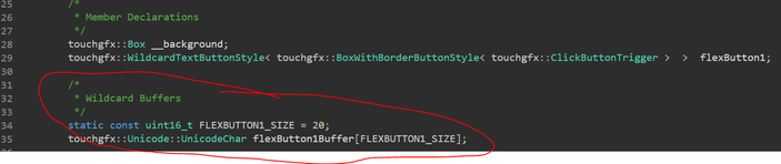

2025-04-17 11:13 AM - edited 2025-04-17 11:17 AM
"I am using a button and not a TextArea."
But FlexButton uses TextArea and also provides access to wildcared buffer. So you do not use
buttonSelectThingA.setWildcardText ()
but change content of the TextArea buffer. In the same way as you use TexAreaWildCard widget.
https://support.touchgfx.com/docs/api/classes/classtouchgfx_1_1_text_area_with_one_wildcard
2025-04-18 3:34 AM - edited 2025-04-18 3:37 AM
Attached is an example showing how to change Flex Button text.
The implementaion in
\gui\src\screen1_screen\Screen1View.cpp
void Screen1View
::changeText () // override final
auto circular_next_ttid = []() -> touchgfx::TypedTextId
static std::array<touchgfx::TypedTextId, 3> ttIds
T_BTN_FLEX_TEXT_ALIGN_CENTRE ,
T_BTN_FLEX_TEXT_ALIGN_RIGHT ,
T_BTN_FLEX_TEXT_ALIGN_LEFT
static std::size_t index = 0;
int result = ttIds [ index ];
index = (index + 1) % ttIds.size();
return result;
Unicode::snprintf
flexButton1Buffer,
FLEXBUTTON1_SIZE,
"%s",
TypedText ( circular_next_ttid () ).getText()
flexButton1.invalidate ();
