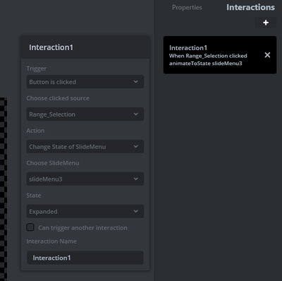

Now I'm stuck with desiging the GUI with TouchGFX. I would like to add the Slide Menu Option to my screen, however when I press on the assigned button nothing happens in the simulator. I looked at the Slide Menu example but I can't see a difference to my setup. Could someone also have a look at my configuration?

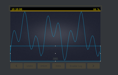

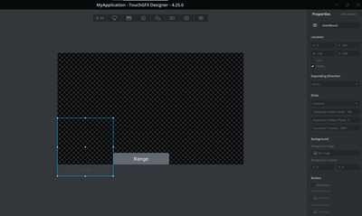

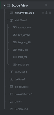

Thanks for the Input, now the defined background slides in, however the buttons don't appear. It seems they are covered by the background?
My configuration now looks like this:
I marked the slide Menu with my cursor.
