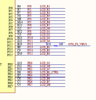

I'm trying to configure the LTDC pheriferal manually but I can't find a schematic of table that tell wich pin of the STMF7 is connectet to a specific pin of the LCD screen. I looked on the STM32F746-DISCO user guide, but I don't find it.

in the cad files you should find, what you looking for:
https://www.st.com/en/evaluation-tools/32f746gdiscovery.html#cad-resources

2023-04-11 3:51 AM
Thank you so much!

The STM32F746 Discovery board has a 4.3-inch LCD-TFT color display with a resolution of 480x272 pixels. The display is connected to the STM32F746NGH6 microcontroller through its Flexible Memory Interface (FMC) peripheral.
Here are the pin connections for the LCD-TFT display on the STM32F746 Discovery board:
Note: These are the default pin connections of the STM32F746 Discovery board. However, these pin connections can be modified using the available solder bridges on the board. Also, the pin connections may vary depending on the specific LCD-TFT display being used.
