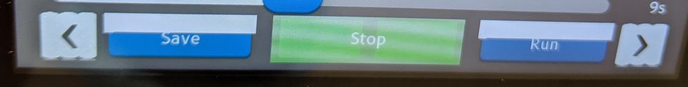

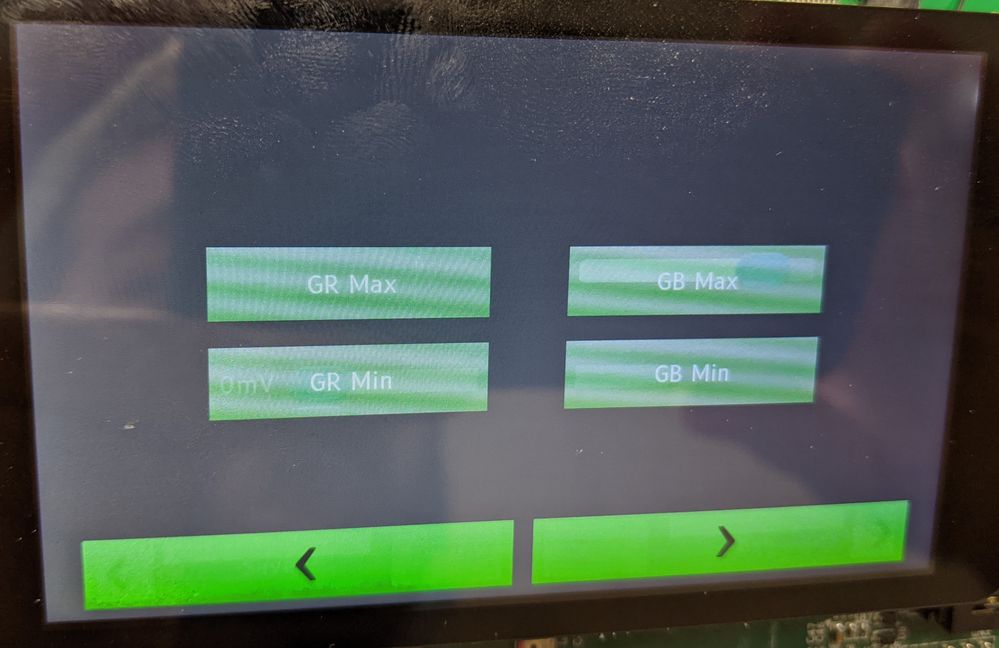

Removing that bit of Text Area "solves" the problem, aka my board boots up, but I end up with either errated colors on my images, or overlapping adjacent screens on/ through my buttons (see pictures). Also the rest of my program does NOT run fine (no comms, no I/O, nothing seems alive - I have yet to determine what is and isn't).

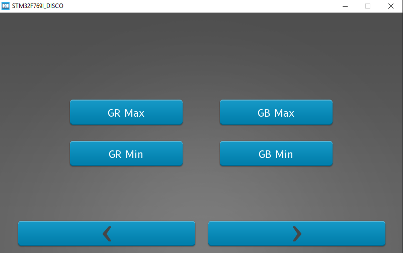

For reference (in simulator, which runs fine in any case):

Artifacts can come from different sources such as the display initialization, the Flash communication, wrong TouchGFX synchronization, etc.
I suggest you compare with the project version that was working to see any discrepancy that seems odd.

Hello, it was running fine in the simulator when I initially posted (you can see the screenshots in my original post).
