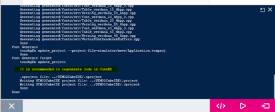

When you update your project you should see these messages :
