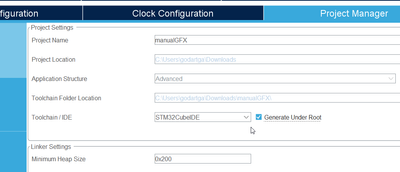

You should not "generate code under root" :

"Generate under root": Unfortunately, since I’ve already created this project, I cannot revert the "generate under root" setting through the .ioc file. I’d need to start a new project from scratch to address this.

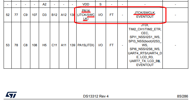

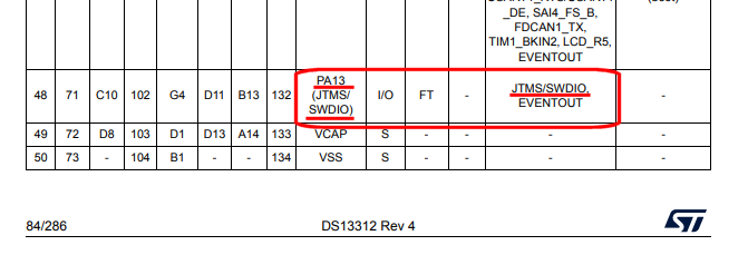

I experienced once the same issue with another board, and it was because of a wrong PIN configuration. It could be interesting to double check that in your project as well. Could you try to unassign PIN PA13 and PA14 from your project and try again? I think those two pins are used by the SWD interface.

@Osman SOYKURT wrote:Could you try to unassign PIN PA13 and PA14 from your project and try again?
I think those two pins are used by the SWD interface..
Indeed they are:
@HispaEmo Using 'Connect Under Reset' should overcome this - provided you have NRST wired to your ST-Link
