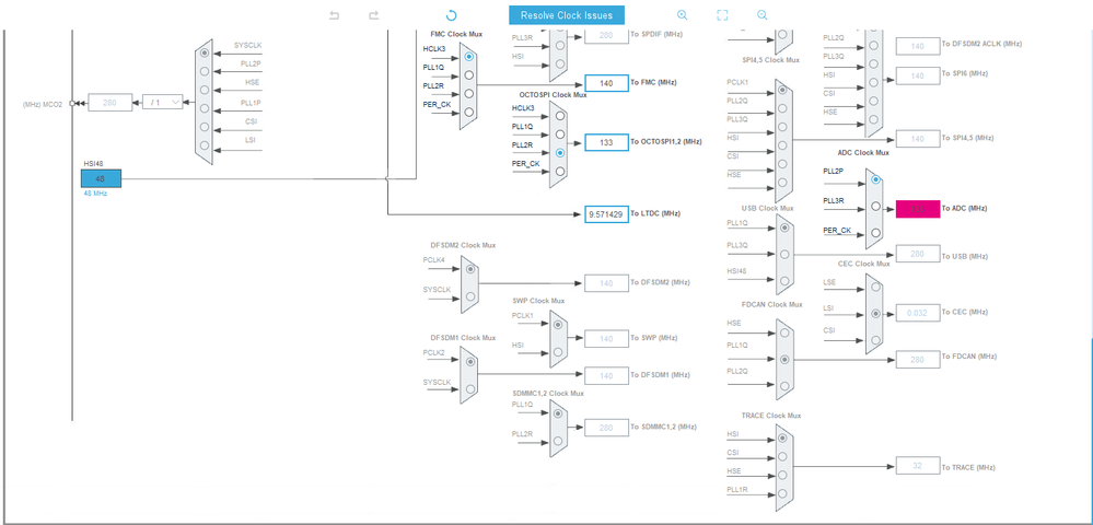

Hello @berkerdemoglu ,
Automatic clock solver should be avoided in situations like this. The issue you're having is that you're ADC frequency can't exceed 50Mhz, you need to reduce it.
PLL2P is currently 133MHz and also used by OCTOPSI so you shouldn't use that clock for your ADC. You could try to use instead PLLR3R or PER_CK since those ones are less than 50.
But since it's preferable to have the highest value here, I recommend to use PER_CK and also you could try to change PER Source to use HSI then you'll have a maximum of 32 MHz.
Could you try that and tell us if it solves your issue?

Need to share a screenshot of the clock message telling you need to solve the issue and also the screenshot after that automatic clock solver showing that white screen. Better to attach you ioc file before accepting to solve the clock issue.
