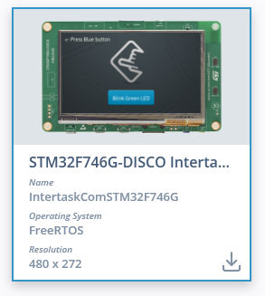

I would recommend you to check this example in TouchGFX Designer instead:
This example will show you how to propagate the data using queues. The most interesting parts are in the main.c when we declare and create the queue (osMessageQueueNew) , then in main_user.c where we send the information (osMessageQueuePut), and finally in your Model.cpp where you get the information (osMessageQueueGet).
I let you check that, and don't hesitate to reach out here again if you need further support :)
