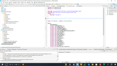

I have an STM32H745 Kit with two processors: M7 and M4.
I created graphics using TouchGFX and built several screens.
I set up the M4 to work with the RTC, and I want to send information from the M4 to the M7 using OpenAMP.
I modified the linker file and built the M4 file.
The issue occurred when I tried to integrate OpenAMP into the HPP and CPP files for each screen. Errors appeared, and I don't know how to deal with them.

call of overloaded 'memset(virtqueue*&, int, uint32_t&)' is ambiguous
invalid application of 'sizeof' to incomplete type 'virtqueue_allocate(unsigned int)::vq_desc_extra'
make: *** [Application/User/generated/subdir.mk:217: Application/User/generated/FrontendApplicationBase.o] Error 1
make: *** [Application/User/gui/subdir.mk:58: Application/User/gui/settingsPresenter.o] Error 1
make: *** [Application/User/gui/subdir.mk:60: Application/User/gui/settingsView.o] Error 1
make: *** [Application/User/TouchGFX/target/generated/subdir.mk:37: Application/User/TouchGFX/target/generated/TouchGFXConfiguration.o] Error 1
make: *** [Application/User/TouchGFX/target/generated/subdir.mk:39: Application/User/TouchGFX/target/generated/TouchGFXGeneratedHAL.o] Error 1
make: *** Waiting for unfinished jobs....
STM32H745I_DISCO_CM4.elf has a LOAD segment with RWX permissions
candidate: 'void* memset(void*, int, size_t)'
candidate: 'void touchgfx::memset(void*, uint8_t, uint32_t)'
