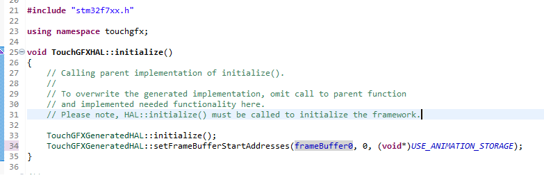

2020-01-27 6:02 AM
Okay @Martin KJELDSEN ! But in which file I have to add this? TouchGFXGeneratedHAL.cpp or TouchGFXHAL.cpp because when I open these 2 files I already found setFrameBufferStartAddresss(void* framebuffer,void* doubleBuffer, void * aniamationStorage)
2020-01-27 6:25 AM
TouchGFXHAL.cpp, you cannot modify GeneratedHAL. You have your HAL::initialize() function there you can use to call the base class init (TouchGFXGeneratedHAL) and reconfigure what you want.
void TouchGFXHAL::initialize()
// Calling parent implementation of initialize().
// To overwrite the generated implementation, omit call to parent function
// and implemented needed functionality here.
// Please note, HAL::initialize() must be called to initialize the framework.
TouchGFXGeneratedHAL::initialize();
}Reconfigure framebuffer addresses here. Use:;
* setFrameBufferStartAddress, with arguments (bitdepth, use animation storage, ...), if you want touchgfx to decide where to place the buffers
* setFrameBufferStartAddresses, if you want to supply the exact location of each buffer
2020-01-27 7:04 AM
I'm sorry @Martin KJELDSEN if I ask lots of question but I really want to learn
Is this correct?
I add :
TouchGFXGeneratedHAL::setFrameBufferStartAddresses(frameBuffer0, 0, (void*)USE_ANIMATION_STORAGE);
