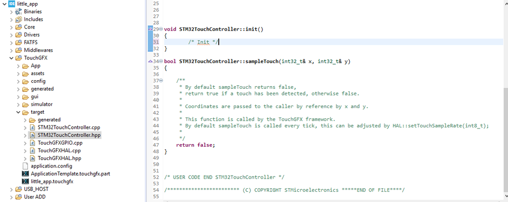

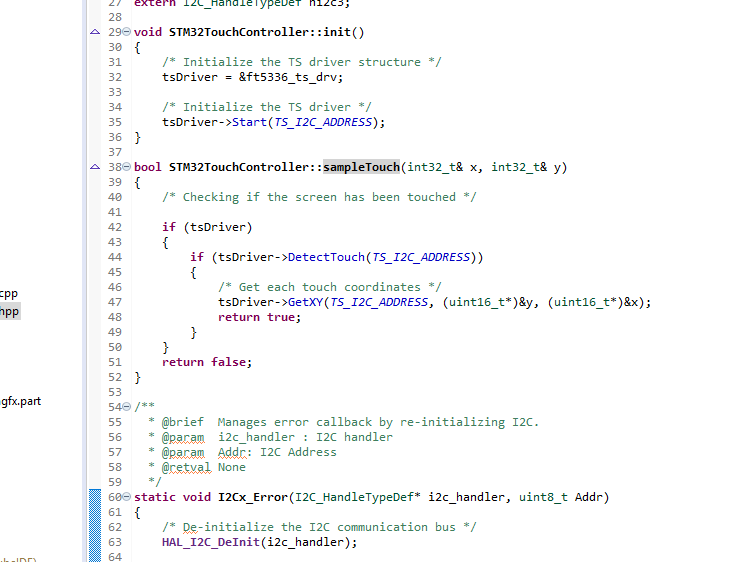

hi @Martin KJELDSEN ,
I created a project with touchGFX without passing through CudeIDE and when I open STM32TouchController.cpp I found some functions that didn't exist in my other project generated by CudeID, here 2 screenshots that explain what I said:
1/ generated by CubeIDE
2/ generated by touchGFX without passing through CubeIDE
and when I tried to copy these functions and paste them in my project, the touch screen on my board works.
but I still wonder why I didn't get them as you in the tutorial?
and if I copy then paste it is correct for the rest of the project?
thank you
2020-01-26 2:52 AM
I'm not sure i follow you. Generally, this is what happens when you create a project through CubeMX/CubeIDE using TouchGFX Generator vs TouchGFX Designer Application Template (everything pre-configured).
TouchGFX Generator: You will get an empty STM32TouchController.cpp because CubeMX/CubeIDE only knows things about the MCU you're configuring, not the concrete touch controller.
TouchGFX Designer: STM32TouchController.cpp will have code to read touch events from the board you chose via the Application Template.
