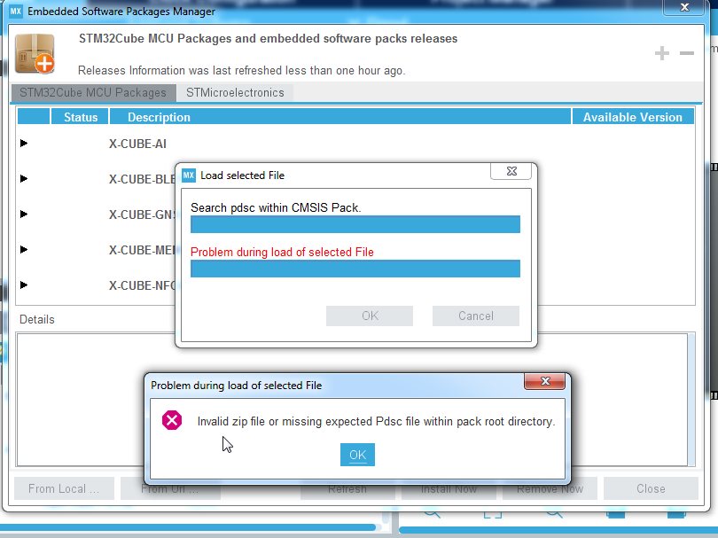

Hello!
In this menu
I can't see X-CUBE_TOUCHGFX.
I downladed it from ST.COM, but when I try to install zip, I see message
How to install X-CUBE-MX???
2020-02-03 2:34 AM
Hello!
Firsrt screenshot is not my screenshot, isit is from your article.
I put it to show place, where problem located.
But now I have solved problem. It was because my Windows has username with cyryllic letters. I set it to non-cyryllyc, and cubeMX begun work well, like on the first screen.

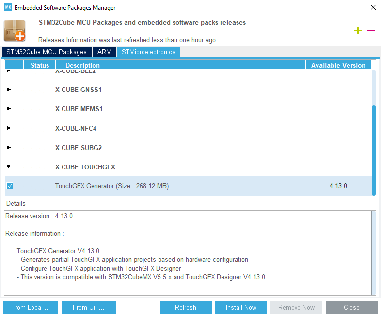

Not being able to install the zip is weird, i'll look into that.
But, in the first screenshot you're pointing to X-CUBE-TOUCHGFX. Can't you press "Install now" ?

2020-02-03 2:41 AM
Aha! Okay, that's great :) If something is not displaying you can also try to press "Refresh", this will cause CubeMX to get a fresh list of what's on the package server.
