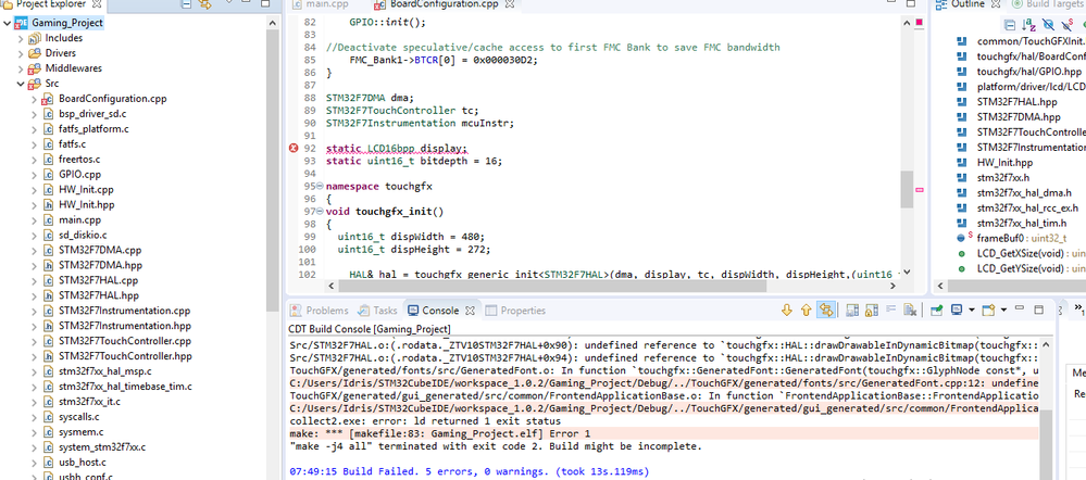

Please show me the log from the designer on why "run target" fails - Which board is this? You need ST-Link installed, and you haven't, is my guess.

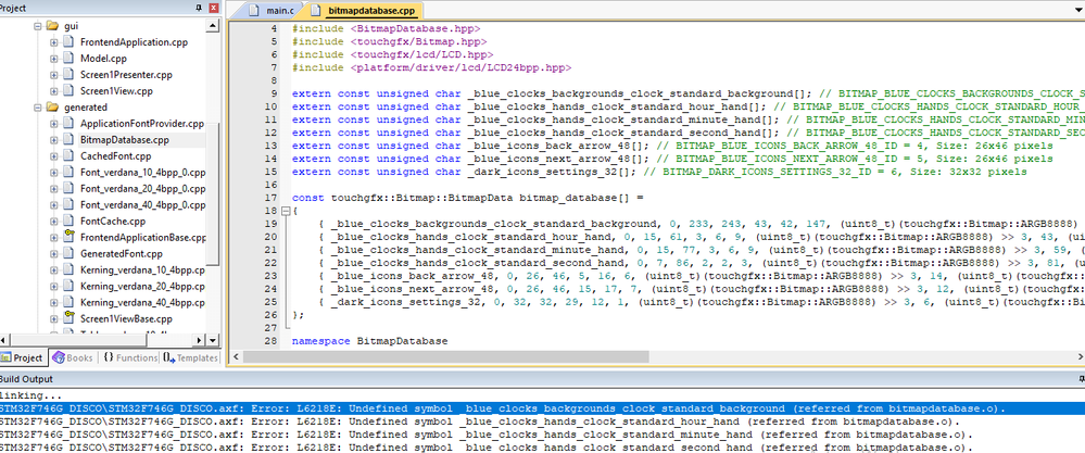

As far as your linker issues - Looks like the generated image code has not been added to your project. This looks like Keil - Did you simply start from an Application template? The "Generate" code button should update the project with new files but you can add them manually - I'm not sure what could be wrong with that - but "Generate code" will fail if it cannot execute its "post generate command".

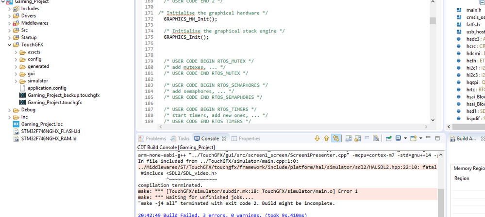

i use the F746G-disco board, I have cubeProgrammer installed, I found the trick but now i have an other problem, PostGenerateCommand "echo test" i put.

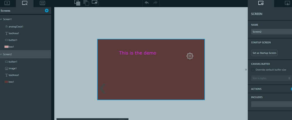

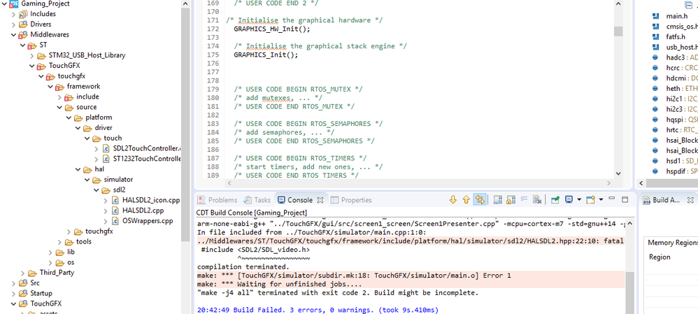

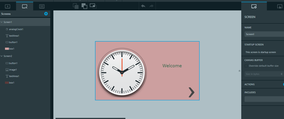

so, I created a project on cubeIDE, I added TouchGFX on the middleware, then I executed TouchGFX Designer, I created 2 screen to test, Then I opened again Cube IDE, and here the errors.
I use Cube IDE 1.0.2 and touchGFX 4.13.0

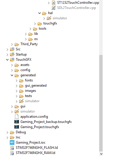

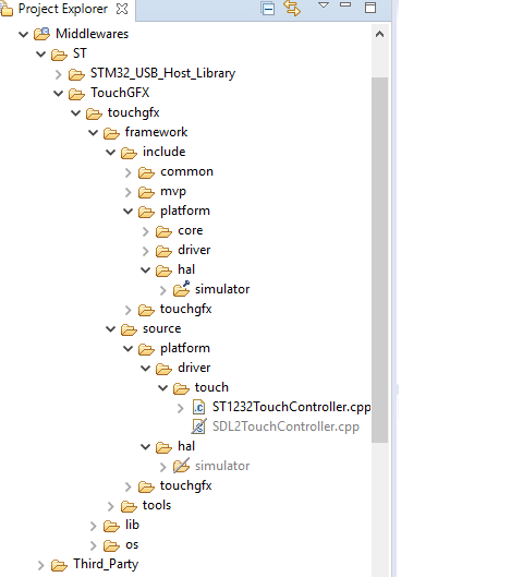

N.B.: I tried to exclude simulators files as someone did on a tutorial but it didn’t work!

It seems that you have followed a guide for an old version of TouchGFX. Be aware that the 4.13.0 have significant enhancements and changes that most likely render the 'old' method obsolete.

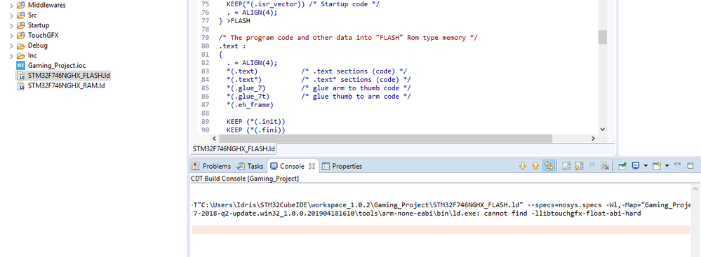

There's a linker error somewhere - Can you show me a bit further up the log window?
/Martin
2020-01-21 5:47 AM
Hi @Martin KJELDSEN ,
14:39:21 **** Build of configuration Debug for project Gaming_Project ****
make -j4 all
arm-none-eabi-g++ -o "Gaming_Project.elf" @"objects.list" -llibtouchgfx-float-abi-hard -mcpu=cortex-m7 -T"C:\Users\Idris\STM32CubeIDE\workspace_1.0.2\Gaming_Project\STM32F746NGHX_FLASH.ld" --specs=nosys.specs -Wl,-Map="Gaming_Project.map" -Wl,--gc-sections -static -L"C:\Users\Idris\STM32CubeIDE\workspace_1.0.2\Gaming_Project\Middlewares\ST\TouchGFX\touchgfx\lib\core\cortex_m7\gcc" --specs=nano.specs -mfpu=fpv5-sp-d16 -mfloat-abi=hard -mthumb -Wl,--start-group -lc -lm -lstdc++ -lsupc++ -Wl,--end-group
c:\st\stm32cubeide_1.0.2\stm32cubeide\plugins\com.st.stm32cube.ide.mcu.externaltools.gnu-tools-for-stm32.7-2018-q2-update.win32_1.0.0.201904181610\tools\arm-none-eabi\bin\ld.exe: cannot find -llibtouchgfx-float-abi-hard
collect2.exe: error: ld returned 1 exit status
make: *** [makefile:83: Gaming_Project.elf] Error 1
"make -j4 all" terminated with exit code 2. Build might be incomplete.
14:39:40 Build Failed. 1 errors, 0 warnings. (took 18s.447ms)

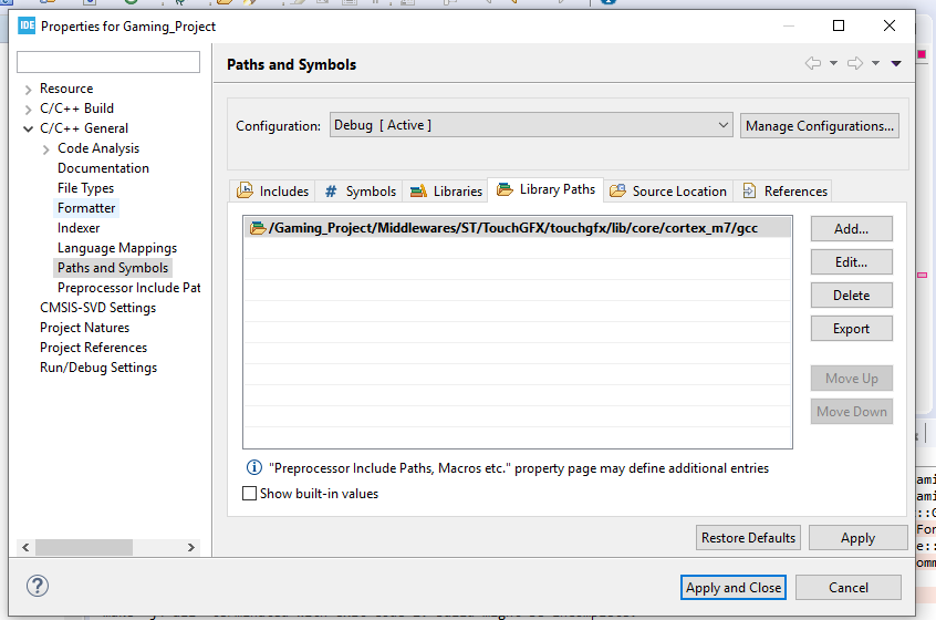

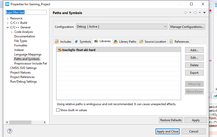

here what i excluded:

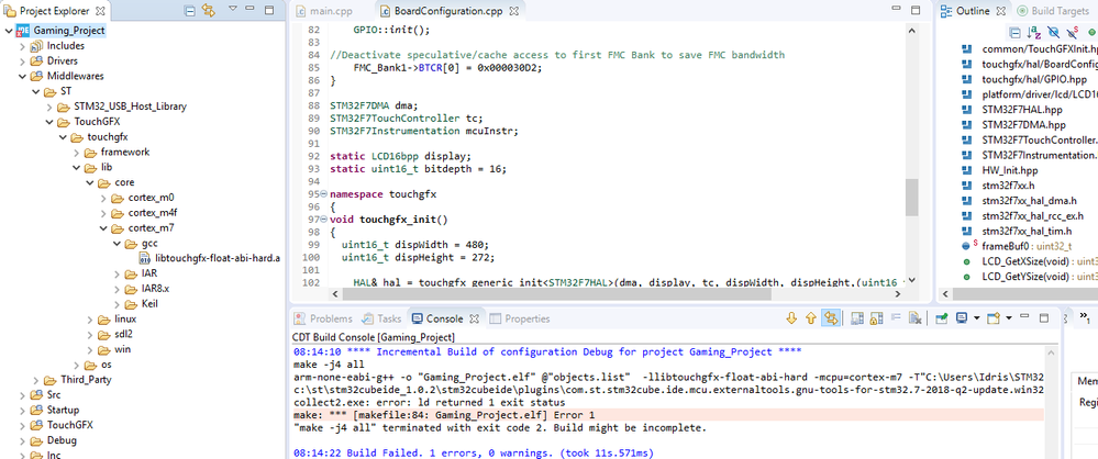

here the path I added:

arm-none-eabi\bin\ld.exe: cannot find -llibtouchgfx-float-abi-hardIs the library on your library path ("Library Paths")? Also, the syntax looks strange, but this may just be representation from CubeIDE since the library seems to be correctly listed in your screenshot.
/Martin
