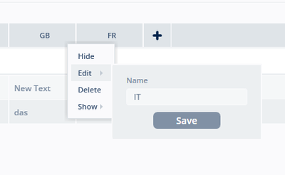

2025-11-06 4:07 AM
By right-clicking on the column, you can both rename and delete the column:
The only constraint is that you cannot have two columns of the same name.
2025-11-06 5:01 AM
If I'm understanding right, this would just rename the column. If I already have content in the column (so translations), it won't change accordingly
I need to reorder the translations, not just rename the column
Or, am I understanding incorrectly?
