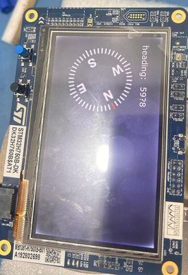

Hello ,
i am using STM32h750B-dk . i took compass image (PNG file) as texture mapper and i want to rotate the compass image according to BNO055 sensor which is magnetometer. this is connected through I2C4 (for I2C4 , STmod+ is used). i have share the codes. Thank you!

2025-03-28 5:18 AM
@GaetanGodart for "." , what we have to setup in setting
Unicode::snprintfFloat(textArea1Buffer, TEXTAREA1_SIZE, "%3f", heading);
textArea1.invalidateContent();
2025-03-28 5:36 AM
If you want to add a single character and not a range of character, you can add it to the field "Wildcard Characters":
Regards,
2025-03-28 5:41 AM
done . thank you so much !
