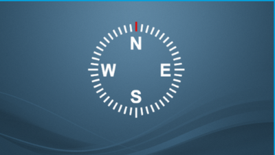

i am using STM32h750B-dk . i took compass image (PNG file) as texture mapper and i want to rotate the compass image according to BNO055 sensor which is magnetometer. this is connected through I2C4 (for I2C4 , STmod+ is used). i have share the codes. Thank you!

Actually there is problem with rotation . the image is not rotating according to the sensor value.. i am not getting the how can i resolve this issue.. video of testing

Are you sure that your display is not frozen? If you are not sure, just add a box and move it 1 pixel every tick.
I have tried to call
textureMapper1.setAngles(0, 0, 3.92699075);
textureMapper1.invalidate();
and it worked fine for me on a simulator.
If you call your function in the simulator (through a button click for instance), does it work?
What about if you call the function (click the button) on target?
