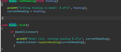

In setHeading , i am getting proper values. but in tick() , i am not getting values
2025-03-26 3:50 AM
Please see How to insert source code - not as images.
Show the definition of currentHeading - is it volatile ?
2025-03-26 3:56 AM
yes the currentHeading is volatile

2025-03-26 4:02 AM
So what do you see in your printf output?

2025-03-26 4:30 AM
the values from sensor like 27.937,81 ,etc
2025-03-26 4:34 AM
@GaetanGodart yes data is not able to transfer from model to screenView.
