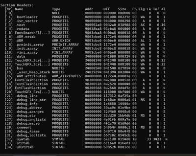

iam trying to read a bin file of my touchgfx project which has along with bootloader code in it. while when we generate the bin the linker script is genarate along with bootloader code.
but here i need a only a bin which has application data which will starts from 0x90000000. how can i do this
why i need?
i need this becouse i wrote my custom bootloader which will read the data using usb and write it in starting address of 0x90000000 and after successfully written then my code jump from the starting address.

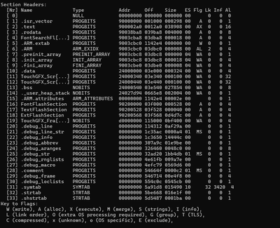

I been facing an issue here, memory got automatically aligning. when I go through bin split. I Have added memory images for your reference.
i tried flash it and run but it's not working. can you help me what I have to do here.
the below picture is after split.
below picture is before split
