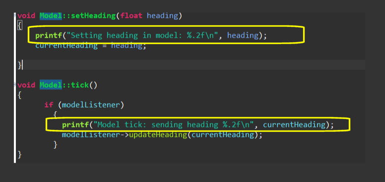

Please show the actual output you get from your printfs - a screenshot or copy/paste text from your terminal
2025-03-26 5:33 AM
ok.
2025-03-26 5:37 AM
That's not the printf output - is it?
I mean the output from these printf statements:
2025-03-26 6:09 AM
Ok, so check the tutorial 3 to see how to manage the model view presenter architecture!
Regards,
2025-03-27 4:51 AM
@Andrew Neil the screenshot i have provided i took while debugging. these reading is from model::setHeading() , and in model::tick() , the current Heading gives 0.
2025-03-27 4:58 AM
ok.. i will check .
2025-03-27 5:39 AM - edited 2025-03-27 6:42 AM
But they don't show the output of your printfs - which is what the running code is actually seeing, in real time.

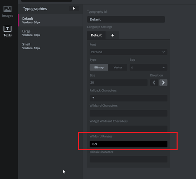

i have able to rotate the compass texture mapper. but the wildcard is not updating the value .
here is the video ->Compass.MOV - Google Drive
2025-03-28 4:57 AM
Hello @Prajyot1 ,
The wildcard show question marks because you have to add the characters that can be in your wildcard. We do that to ensure that we don't add characters that are not used because they take memory space.
To add characters, go to your typography (the one you use for that textArea) and add characters to the wildcard range (here I put 0-9 to be able to use all the numbers but you can put any char you want). :
