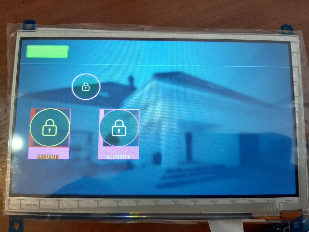

The problem is
The project is in the memory of mcu (flash).
button - OK
The project is in the memory of QUADSPI.
what could be the problem?

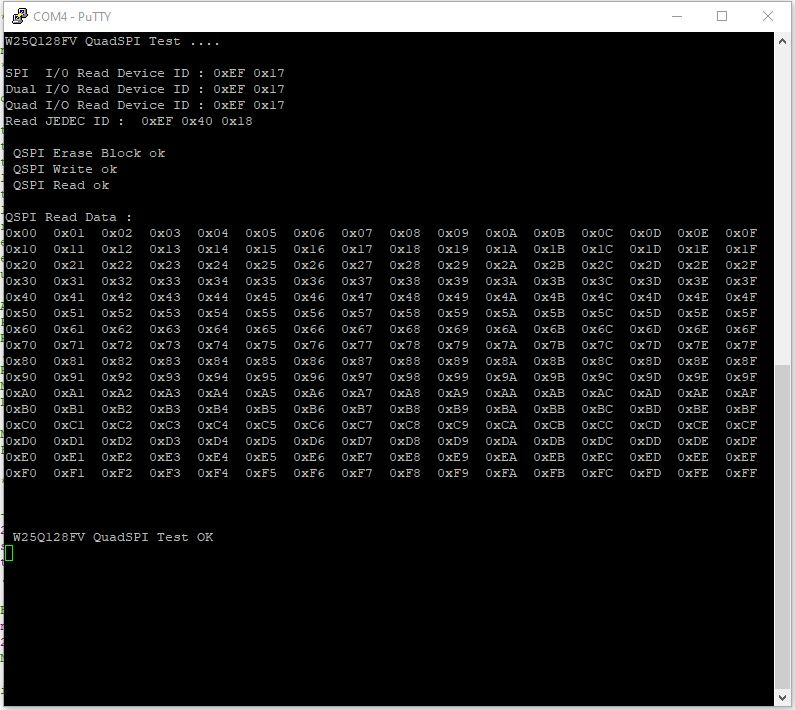

I see you are using a custom hardware (QSPI W25Q128 and others). Did you run sort of validation tests to make sure writing and reading from the QSPI is fine?

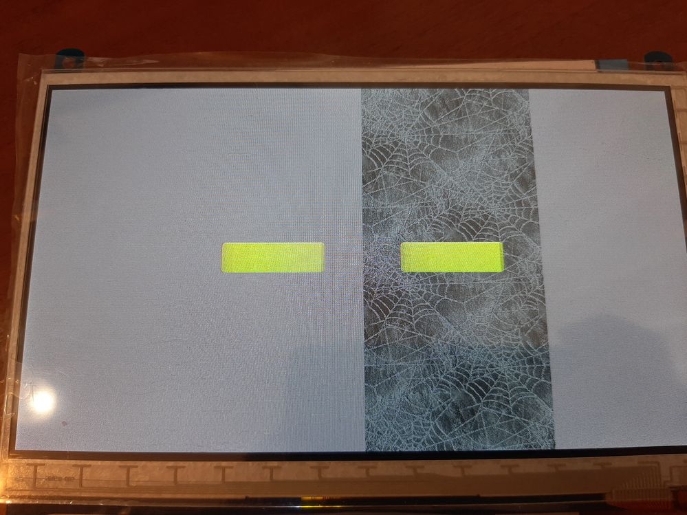

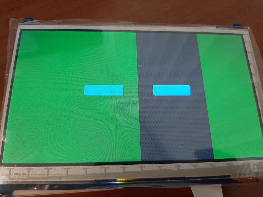

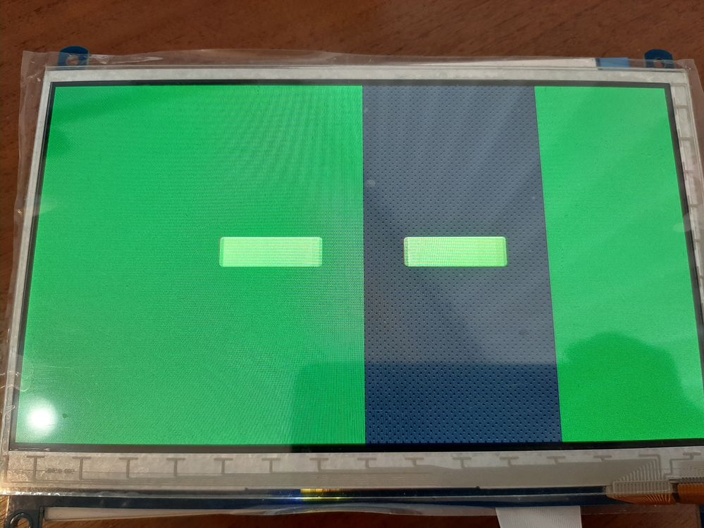

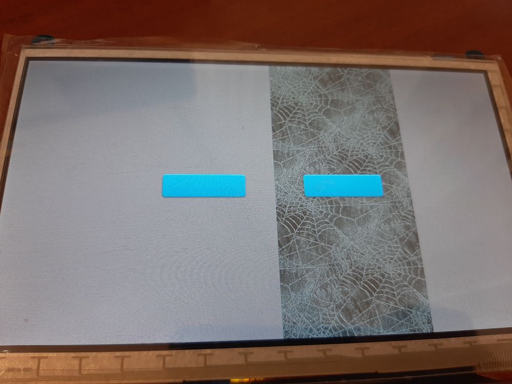

2019-10-03 3:16 AM
2019-10-03 3:22 AM
These files are displayed correctly.
These files are not displayed correctly.
(png with transparent background)
