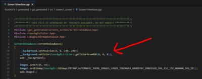

TouchGFX is primarily designed to be used as a "stand-alone" LTDC layer. What is your use case for multible LTDC layers?
When generating code in TouchGFX Designer, it will insert a black background box to ensure that all pixels are written. You can see this in the generate code for your view like this:
You can try hiding this black background by adding this code the following code to the setupScreen method in our user code file:

Thanks for your reply. Actually, I’m not using TouchGFX as a two-layer setup. Instead of rendering on LTDC layer 0, I made it render on LTDC layer 1. I want to put a camera feed on LTDC layer 0, and I plan to do this manually.
Now, I tried using __background.setVisible(false);, but instead of making the background transparent, it showed the leftover image from the previous screen.

Ok. The behavior is a bit different depending our your rendering method (software, DMA2D or GPU2D). What MCU are you working on?
You can try keeping the background box visible but setting it to transparent, with this code line instead of the previous suggestion:
2025-08-15 2:38 AM
I’m using a DMA2D on an F7 series MCU, and the __background.setColor(0); method still seems to produce a black color.
