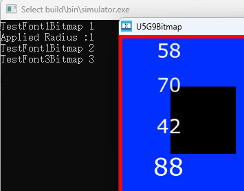

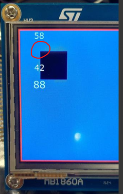

I would like to capture a TextArea's content and use it with TextureMapper for scaling animation and a blurry filter effect on the bitmap data.
However, there is noise for the TextArea background in HW, but the simulator result is perfect.
The reasons for using TextureMapper with Bitmap Data:
How to create a Bitmap Data with Font/image's content without a noisy background?
STM32U5G9-DK Result (noise for the Background):
Simulator Result (expected):

The noise you see in the dynamic bitmaps comes from the memory not being initialized. You can e.g. fix this by inserting the following between line 4 and 5 in your code snippet above:
memset((void*)TestFont1Bitmap.getData(), 0, TestFont1Bitmap.getWidth() * TestFont1Bitmap.getHeight() * 4);Be aware that you might see another glitch (with the text characters being "scrambled") when reprogramming a running board. This can be solved by power-cycling the board or by inserting the following code to the last user code section of MX_DCACHE2_Init function in main.c:

@PeterVang Thank you so much. The Noise background issue is fixed.
I got another issue that I tried to apply a Blur function to the Bitmap data, the simulator could review the result, but the Hardware failed.
Any idea about this issue?
Any Demo/ Example that applied a filter effect to the Bitmap Data?
Any plan to add a built-in filter feature in TouchGFX in the feature?
STM32U5G9-DK result:
| Radius = 1 | Missing TextureMapper "FontTM" |
| Radius = 2 | Triggered HardFault |
Simulator result:
| Radius = 1 | Normal |
| Radius = 2 | Normal |

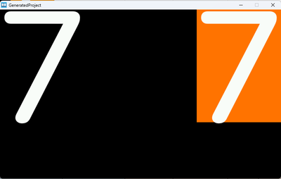

I tried the TouchGFX-generated project to review the Pixel parameters in LTDC.
LCD setup from: https://community.st.com/t5/stm32-mcus-touchgfx-and-gui/how-to-create-argb8888-dynamic-bitmap-on-rgb565-platform/m-p/835516
static LCD32bpp lcd32;
#define BITMAP_CACHE_SIZE (400*400+32*4) //Size of the bigest cacheable container + meta data
LOCATION_PRAGMA_NOLOAD("TouchGFX_Framebuffer")
uint32_t bitmapCacheBuffer[BITMAP_CACHE_SIZE] LOCATION_ATTRIBUTE_NOLOAD("TouchGFX_Framebuffer");
FrontendApplication::FrontendApplication(Model& m, FrontendHeap& heap)
: FrontendApplicationBase(m, heap)
HAL::getInstance()->setAuxiliaryLCD(&lcd32);
Bitmap::setCache((uint16_t*)bitmapCacheBuffer, sizeof(bitmapCacheBuffer), 2);
}The Container & Bitmap setup code:
void Case4CusContainer::initialize()
Case4CusContainerBase::initialize();
touchgfx_printf("TouchGFX Project case2\n");
SetupBitmap();
void Case4CusContainer::SetupBitmap()
ImageBitmap = Bitmap::dynamicBitmapCreate(240, 325, Bitmap::ARGB8888);
touchgfx_printf("ImageBitmap :%d\n", ImageBitmap);
if(ImageBitmap != BITMAP_INVALID)
uint8_t* const bitmapPixels = (uint8_t*)Bitmap::dynamicBitmapGetAddress(ImageBitmap);
memset(bitmapPixels, 0, ImageBitmap.getWidth() * ImageBitmap.getHeight() * 2); // HW Fixed Noise Background issue
HAL::getInstance()->drawDrawableInDynamicBitmap(ImageTM, ImageBitmap);
BitmapTM.setBitmap(ImageBitmap);
BitmapTM.setPosition(560, 0, 240, 325);
BitmapTM.setBitmapPosition(0, 0);
BitmapTM.setupAnimation(AnimationTextureMapper::SCALE, 1.0f, 0, 0, EasingEquations::linearEaseInOut);
BitmapTM.startAnimation();
My expected Result would be:
1. Copy the Image TextureMapper content, and convert into ARGB8888 Bitmap format, and place it into the a new Texture Mapper.
2. Set the new Texture Mapper location on Top of the orange region.
Here is my test result:
| LTDC Config | TouchGFX | Dynamic Bitmap | Result | ||||
| case | Pixel Parameters | Frambuffer Pixel Format | Frambuffer Strategy | Buffer Location | Format | Sim | HW |
| 1 | RGB565 | RGB565 | Double Buffer | By Allocation | ARGB8888 | Fail (no "7" display on top of the orange region) | Fail (no "7" display on top of the orange region) |
| 2 | ARGB8888 | ARGB8888 | Singal Buffer (RAM resouce) | By Allocation | ARGB8888 | Matched to my expected result | Matched to my expected result |
It is failure to show the ARGB8888 Dynamic Bitmap Data under RGB565 pixel parameters config in LTDC.
Please found the attached files for reference.

2025-11-07 2:14 AM
What I want to do:
1. Convert the "7" texture Mapper image (In a real application could be a TextArea instead of an Image) into a Dynamic Bitmap with ARGB8888 to handle the transparency. The Dynamic Bitmap shows successfully only when the LTDC pixels parameter is also ARGB8888.
2. Apply the blur effect to the Dynamic Bitmap data. It could be applied now.
I am confusing: How to setup LTDC/TouchGFX/Dynamic-Bitmap/Code that could using Dynamic Bitmap with ARGB8888 (for Transparency) format and LTDC pixels parameter is RGB565 (free more RAM resource).
