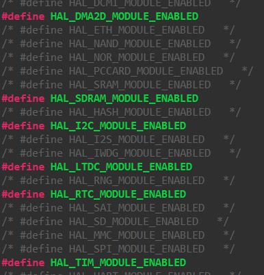

2022-03-01 11:07 PM
Yes the above picture in inside hal_conf.h as you can see the second last define shows it has been enabled by default.

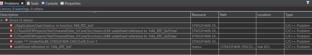

I'm not sure, looks like it should be working. Can you post the exact error message(s) you're getting?
