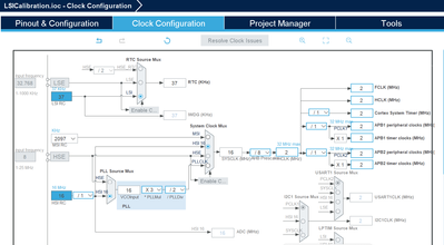

This is my clock configuration:

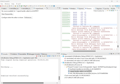

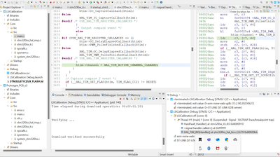

2024-10-04 8:53 AM
Look at the instructions that are faulting, and the registers in the MCU
Check SP is within expected scope and properly aligned.
Have a Hard Fault Handler that prints out the details.
You don't scope the incrementing pointer into a finite array
The value for R7 probably exceeds the bounds of RAM, you'd have to look at it to know

2024-10-04 8:35 PM
@Tesla DeLorean ,Most likely, the stack is overflowing because the interrupt does not stop correctly, and the array buffer keeps increasing. I'm wondering why using a 2 MHz clock cannot stop the timer interrupt correctly, whereas the 4 MHz clock can..
