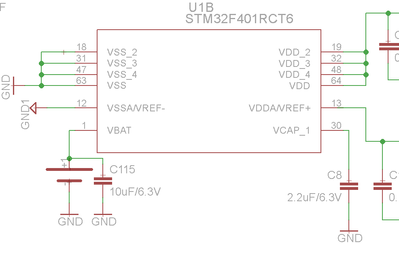

Here is the schematic of my RTC circuit.

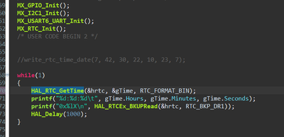

Main Code:
Here is my RTC init function:

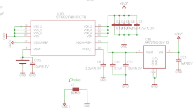

VDDA/VREF+ are connected together and are powered by using a separate LDO power supply. This is done to keep analog and digital voltages separate. Also, I would like to mention that VSSA/VREF- are connected together and are shorted to digital Gnd using a choke. This is done to keep analog and digital Gnds on separate sides (but still connected using choke).
Here is how the supplies are:
The please note in the image below VSSA/VREF- are on separate GND node and the choke L3 is used to connect both the digital and analog Gnds.

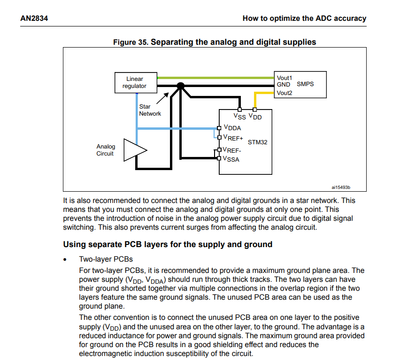

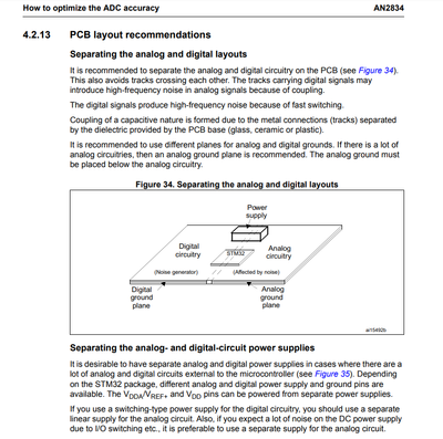

However we have followed ST app note AN2834 to design analog circuitry. On page 42, 43 it clearly suggests to keep analog and digital supplies separate and to connect analog and digital Gnds at one single point as we did using choke.
Here is the link for app note (Page 42,43)
Here I have attached its screenshots
I can remove choke on GND line and short them directly, however in our another test board there is no such choke but still it gives the same RTC problem. I really do not want to merge VDDA and VDD, since keeping them separately has impacted hugely on our analog reading section.

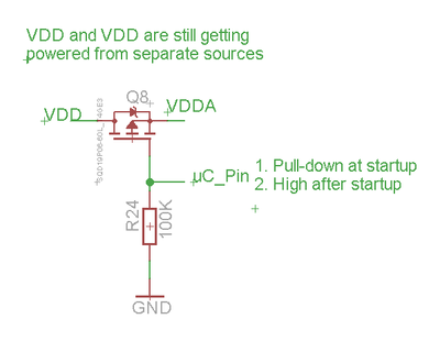

first: try connecting vdd+vdda ; if this solves the problem, you could
1. try bridging vdd-vdda with 2 antiparallel schottky diodes
2. bridge vdd-vdda with a (low impedance) P-mosfet, gate with pulldown on a cpu-pin; after startup, switch pin hi ; mosfet off then.

To confirm I get you correctly, Is this how you want me to test your 2nd option?
In this, I am considering
1. VDD and VDDA are still getting power from separate sources.
2. Keep mosfet pulled down at first and then give high to disconnect both the supplies.
