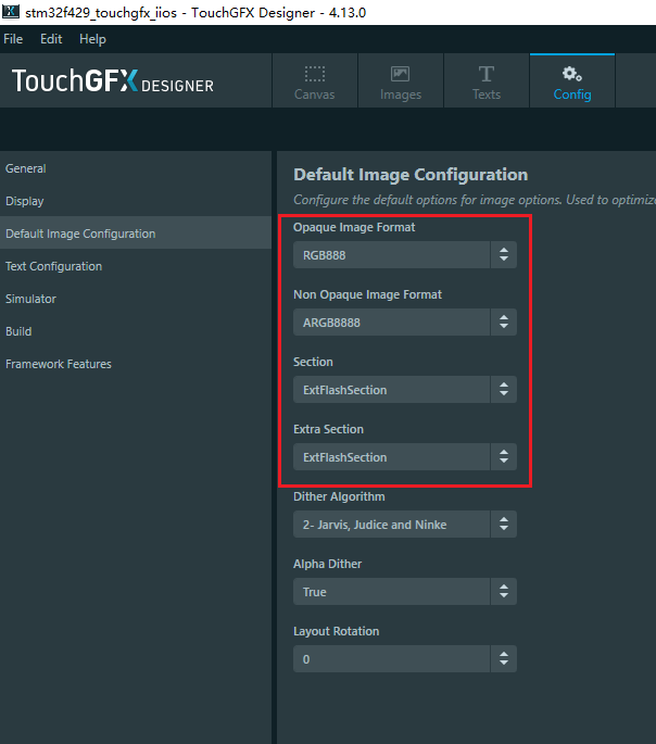

I'm working on a STM32H7B3I-DK with a 565 format frame buffer.
In my design, the Serial Flash that contents the ExtFlashSection in a standard project will not be memory mapped because I need part of it to record other data.
I followed the topics about caching bitmaps (https://support.touchgfx.com/docs/development/ui-development/touchgfx-engine-features/caching-bitmaps and https://support.touchgfx.com/docs/development/ui-development/scenarios/using-non-memory-mapped-flash )
In TouchGFX Designer, if I put the ’section’ part of the image to ExtFlashSection and the ‘Extra Section’ (e.g. the CLUT) in IntFlashSection everything is fine.
But if I try to put the ‘Extra Section’ in the ExtFlashSection the engine crashes on a HardFault because the library code tries to access directly the extra section in a memory mapped fashion.

2020-06-05 9:28 AM
Hi PJEN,
First of all, thank you very much for your response.
The problem I'm having is that the blockCopy() method is not called, and I don't know what the problem is, I'll list the changes, please help, thanks!
I modified the load file to fix the hardfault issue(I'm using KEIL).

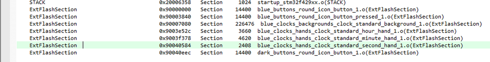

My image data are stored like in the screenshot below
Here's what my image looks like in the .map file

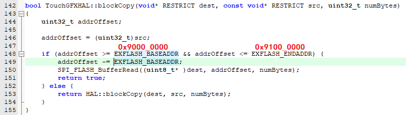

According to the official doc about "Caching Bitmap", modify the code as follows
According to the official doc about "Using non memory mapped flash", modify the code as follows

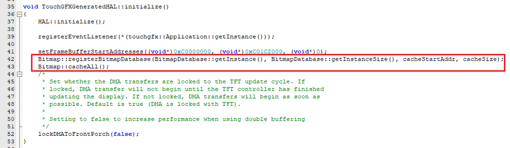

2020-06-05 10:18 AM
I suspect that your problem is that the Bitmap::cacheAll() is called too early (before the initialisation process is done), you need to cache the Bitmap just before you use it .
First, in my case, the call to registerBitmapDatabase is done in the touchgfx_init() function found in target/generated/TouchGFXConfiguration.cpp (I'm not sure but I think that this call to registerBitmapDatabase is written by the Designer (without the parameters giving the bitmap cache memory !!) .Check this TouchGFXConfiguration.cpp file in your project and if the registerBitmapDatabase call is there, make the cache init there to not call registerBitmapDatabase() twice ).
Next, in my project the Bitmap::cacheAll() is called in the setupScreen() function of the start screen (it's called Splash in my project):
void SplashView::setupScreen()
Bitmap::cacheAll();
SplashViewBase::setupScreen();
}I tried to move this 'cacheAll()' call in the initialisation code like you do and the program crashes !!
Cross the fingers ;)

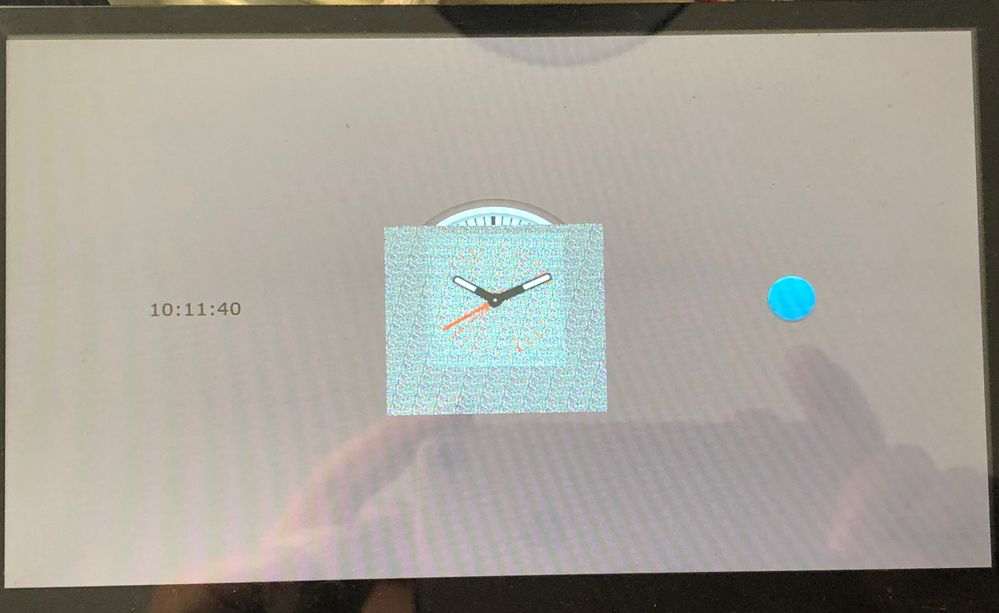

2020-06-06 2:39 AM
Hi PJEN,
I modified it as you said and it now displays the image, but there are still some problems!

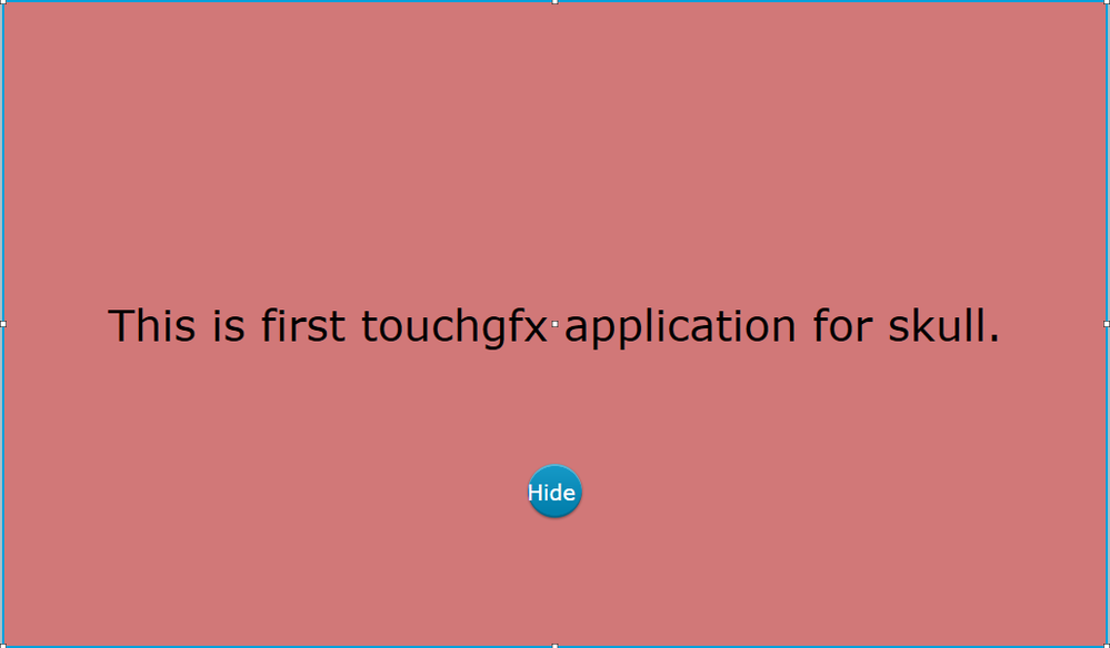

My current project is composed of two screens, the start screen shows normal, the second screen shows abnormal, the specific display is as follows

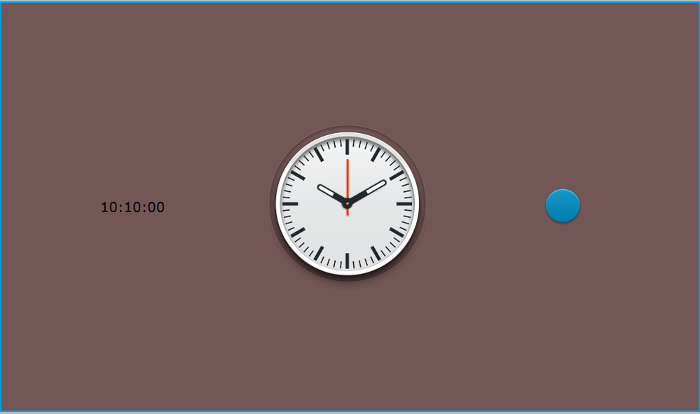

A normal display screen should look like this

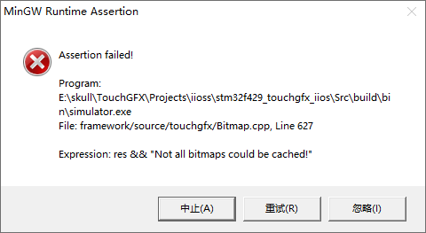

For the simulator, the message seems clear ... there is no memory to cache the bitmaps.
The Simulator does not run exactly the same code as the target, you'll have to specify cache memory for the simulator run.
Modify the TouchGFX/simulator/main.cpp to something like that :
(See line 15 that declare a 4Mbytes cache area and line 36 that register this cache area )

}On the target, it's like some bitmaps where not correctly cached ... Check the size of the RAM you allocated for the cache ... Check the function that copy the Flash to the cache during BlockCopy ... verify that the images have been correctly stored in the external flash ...
2020-06-06 10:25 AM
PJEN, Thank you very much for your patience in answering my questions.
I solved the simulator error problem with target board macros.
The image is not displaying fully, I checked the data reading interface and found that it's the spi reading that's having a slight problem.
