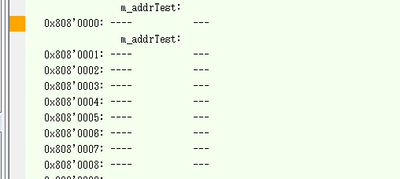

Thank you for your reply. I followed your advice and changed copytest() to the following, but the flash write on line 28 did not occur.
(I immediately checked the address value in disassembly, but it showed "----" and could not be obtained, so I concluded that this was the case.)
Also, a HardFault occurred when reading(line 33).

2026-02-09 6:38 AM
> HAL_FLASH_Program(0x00
You must write the entire flash word at a time. 0x00 is not a valid argument here. It must be FLASH_TYPEPROGRAM_FLASHWORD.
> m_addrTest
This variable is never initialized. What is the purpose of "getTestWord = m_addrTest" here?
