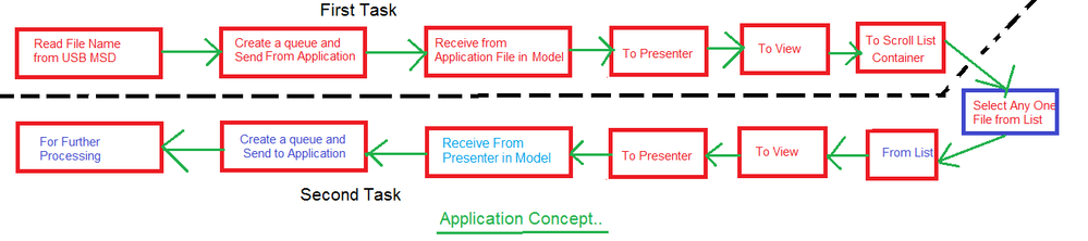

In my application, I have to copy File from USB Mass Storage to SDCard with TouchGFX GUI (Scroll List) with Add/remove feature .
USB Mass Storage and SDCard with FATFS + exFAT works well without TouchGFX .
How to I transfer "File Names" from USB Mass Storage to TouchGFX GUI scroll list?
So for simplicity, I have created array in main.c then try to transfer to GUI Scroll List Items.
But so far there is no example I have seen on touchgfx website, Is this the prefect/right method of not ?
I have written some steps as attachment .
Please advice how to proceed this ..
Thank in advance ..
Karan
2020-05-14 12:45 PM
I mean to say that how to propagate data (Array -2D) File Name in my case :
From
Application data (File Names) -> Model -> Presenter -> view -> Scroll List Items(Custom Container)
and
Scroll List Item -Select any one) (Custom Container) -> view -> Presenter -> Model -> Application
For further processing..

I am seeking example program or How I can do
To propagate data (Array -2D) File Name in from Application data (File Names) -> Model -> Presenter -> view -> Scroll List Items(Custom Container).
and Scroll List Item -Select any one) (Custom Container) -> view -> Presenter -> Model -> Application

}When fileNames (RxBuffer) string received by queue ..,
Can you give check below and add/correct that how to do
-> Model -> Presenter -> view -> Scroll List Items(Custom Container) ?
