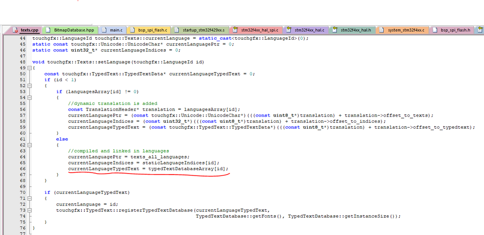

Hi,PJEN
I'm using STM32F429 to put touchgfx image resources in external unmapped serial flash, debugging found into Hardfault, I also refer to the official <Caching Bitmaps> and <Using Non-Memory Mapped Flash for storing images>, also just started to use touchgfx, hope you can describe what modifications to make to put touchgfx image resources in external unmapped serial flash.
Execute the code as follows to the red line 66, and you will enter hardfault:
