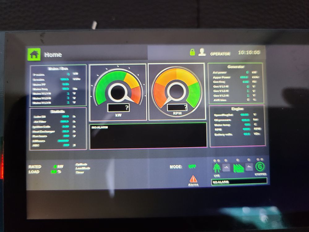

2023-06-08 10:51 PM - edited 2023-11-20 3:59 AM
SAMSUNG TAB3 7.0 ,, 1024x600 , LVDS LCD & TouchGFX (STM32F429i-DISCOVERY)
CHINESE 800X480 TFT (DE Mode) & TouchGFX (STM32F767 WILDFIRE BOARD)

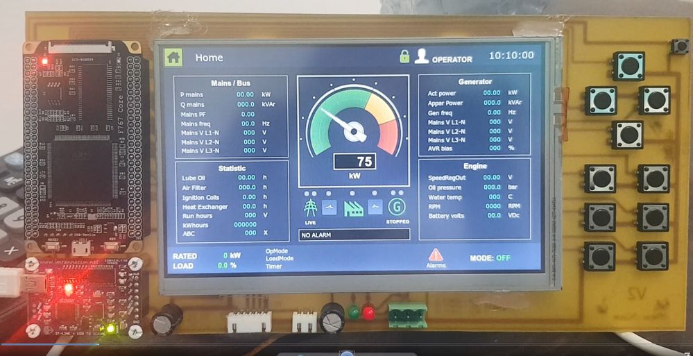

2023-06-08 11:55 PM - edited 2023-11-20 4:00 AM
Here is TouchGFX , running on 5.0" ,, 720X1280 ,, RGB + SPI TFT with STM32F429i-DISCOVERY
LCD PART No. TL050HDV31CT5-H1206A
The lcd driver chip/COG is NV3052

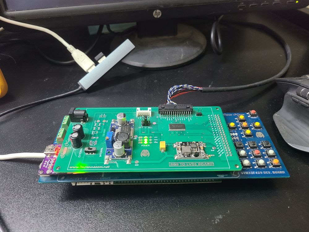

Sure ... I will mention , how to generate BSP files in my aticle. Also will try to spare some time on Sunday to check your application. But don't forget to follow and likes for me !!

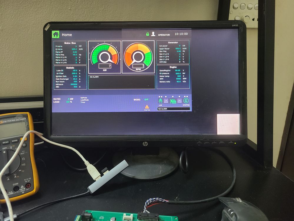

Here is TouchGFX running on HP S1932 18.5" Monitor's LVDS LCD with 1366x768 resolution .
The lcd part no. is LTM185AT04 or Equivalent . The driver is stm32f429i-discovery + sn75lvds83b
I made custom board for lvds type lcds ..
Sorry about dust on my work , the weather is too hot now a days ..
Tested following lcds.
SAMSUNG TAB3 7.0" , 1280x600 TFT
THINKPAD T400 14.1" , 1280x800 TFT
GENERIC TFT MONITORS , from 14.1" to 18.5" Maximum tested resolution is 1366x768 TFT
