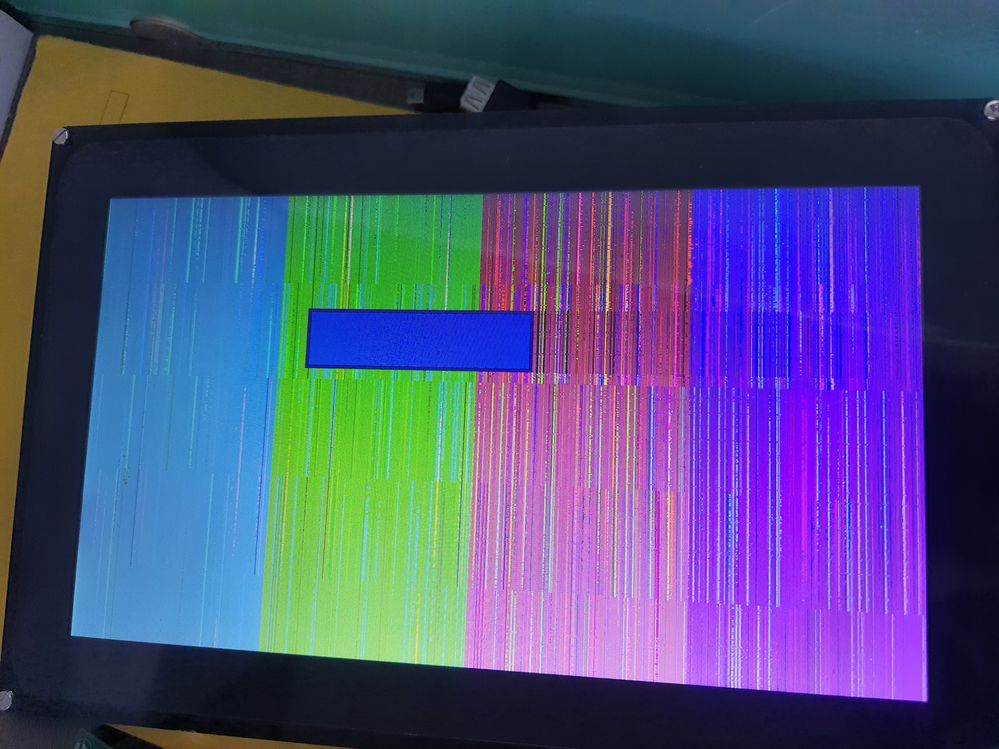

2023-06-09 1:58 AM - edited 2023-11-20 4:00 AM
When i commented mx_quadspi_int() .. now its displaying one button that i configured in touchgfx but still background is not coming ...
Through this button i toggled one led also ... and LED is getting toggled without any issue.
i think this background issue is coming during fetching the background from memory
Might be im missing something 樂

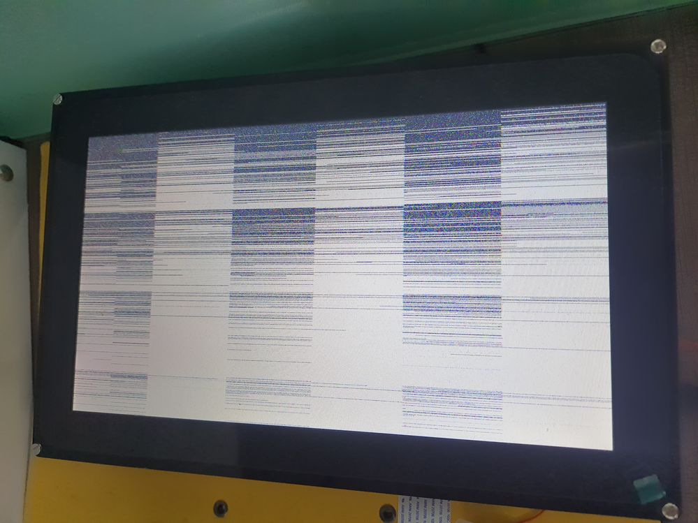

2023-06-08 2:41 AM - edited 2023-11-20 3:58 AM
@Jukka Pöppönen
I commented videoTaskfunction and now im getting flickering display...
2023-06-08 4:25 AM
Good :thumbs_up: for me it looks that LTDC parameters/polarities are wrong. What is the type of display ?

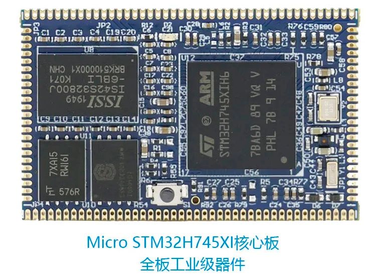

my recent development across STM32H745XIT6 Core Board and 1024X600 TFT running TouchGFX .
imran

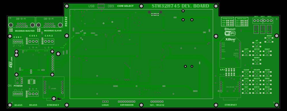

I am writing an article about LTDC & TouchGFX configuration.
Next week I will post in this forum .
My above custom designed board is with a lot of communications options.
I also tested TouchGFX With Modbus Master RTU on my previous dev board across stm32f429-disco & also stm32f767 wildfire core board with 800X480 & 1280X720 tfts.

Since TouchGFX need powerful controller so I developed the above board with dual core i-e stm32h745xit6 core board as under.
Since TouchGFX examples about my target core board was not available so I worked on BareMetal project for stm32h745xit6 and got TouchGFX running .
My plan is to run TouchGFX on CM7 & all communication protocols on CM4 with shared memory.
