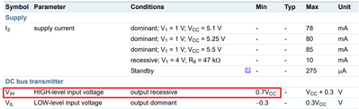

The transceiver you are using is a 5V device incompatible with STM32 and it doesn't have VIO input to adapt the voltage levels like many other transceivers.
From the transceiver's datasheet:
VIHmin = 0.7*VCC = 0.7*5V = 3.5V which is > VDD MCU.
You will say, ok but it's is working with 125kb/s. Yes it's working but out of specification. So you will face random issues and unstable communication.
So please use another CAN transceiver such as SN65HVD230. It's already used in many STM32 eval boards.
So replace that PCA82C251 tranceiver before going ahead.
