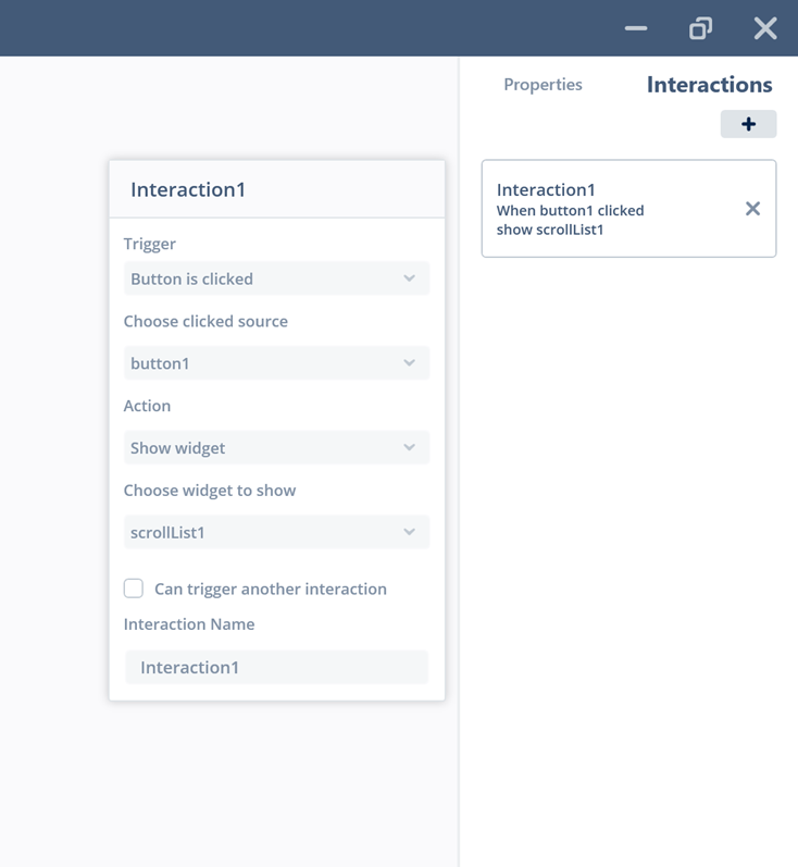

Hello @MA.2 ,
There is a very easy way to do what you want using TouchGFXDesigner widgets interactions :
Don't forget to uncheck the "Visible" checkbox inside the properties of your ScrollList, so it can appear only when the button is pressed, and not before.
Hope that this helped you,
/Yoann
2022-03-03 9:55 PM
thanks sir, i will be back with more questions

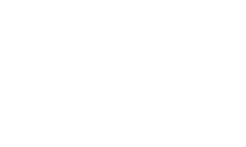

can i do the same thing for custom container (radio button inside) if it is yes,
how i hide the container when a radiobutton inside the container is clicked,can you suggest some way to this.
also how to make a selection table for selecting positions like above figure
