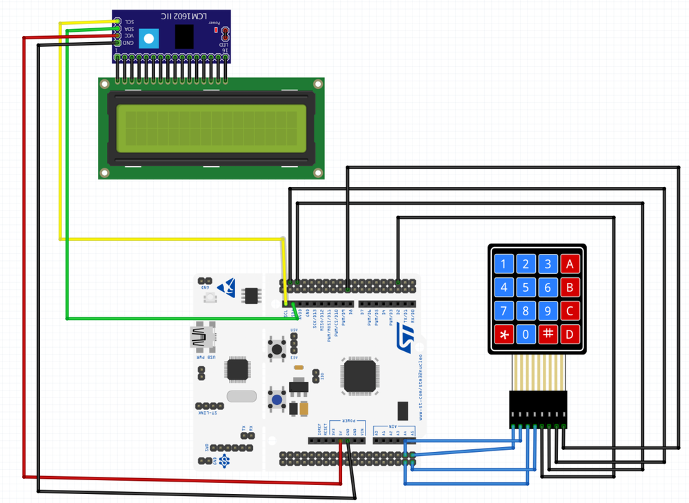

}Hello all
I learn ( code below) !!!
Blue button is on EXTI - works. When press LED2 blinks, press again - LED stops blink ( work as expected)
Press on Blue button also sends message ( debugging purposes ) to Serial comm 9600 ( works as expected )
Now I added Keypad_Read() function to read pressed key ( this doesn't work ) Please advice me on getting
keypad only
connected 4x4 keypad as below
My code below

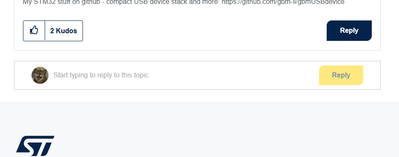

@Roman_E wrote:My apologies, but "reply" interface kinda complicated ( regarding previous thread)
Seriously?
There's a 'Reply' button on each post (the black one) - use that to make a reply specifically to one post;
There's also a box at the bottom of the page (with yellow button) - use that to make a general contribution to the topic:
But don't just abandon that thread.
People have made suggestions to you - so give them some feedback.
You can use @ to mention multiple people in one post.
