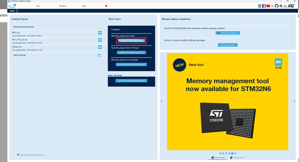

2026-03-08 8:11 PM
When I clicked the "Access to MCU Selector" button, the interface did not respond. The pointer just kept rotating to indicate loading. However, when I clicked the "Access to Board Selector" button at this time, the selection interface could be opened.
On the board selection interface, when I clicked the MCU/MPU Selector interface, it still showed the situation where the pointer was rotating and indicating a loading process, and I did not enter the MCU selection interface.

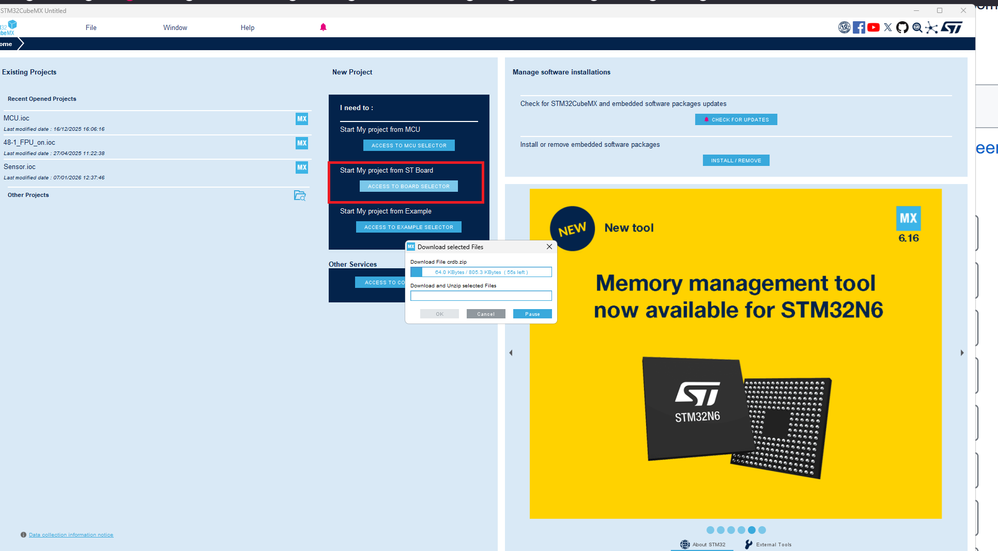

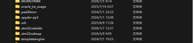

2026-03-09 7:55 PM
As shown in the picture, I deleted these two folders.Then I ran STM32CUBEMX as an administrator.
The same problem as before still occurred, such as the pointer just rotating in circles but the MCU selector did not appear.

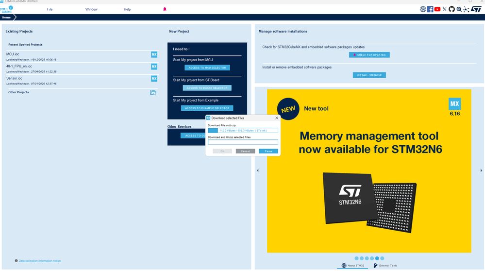

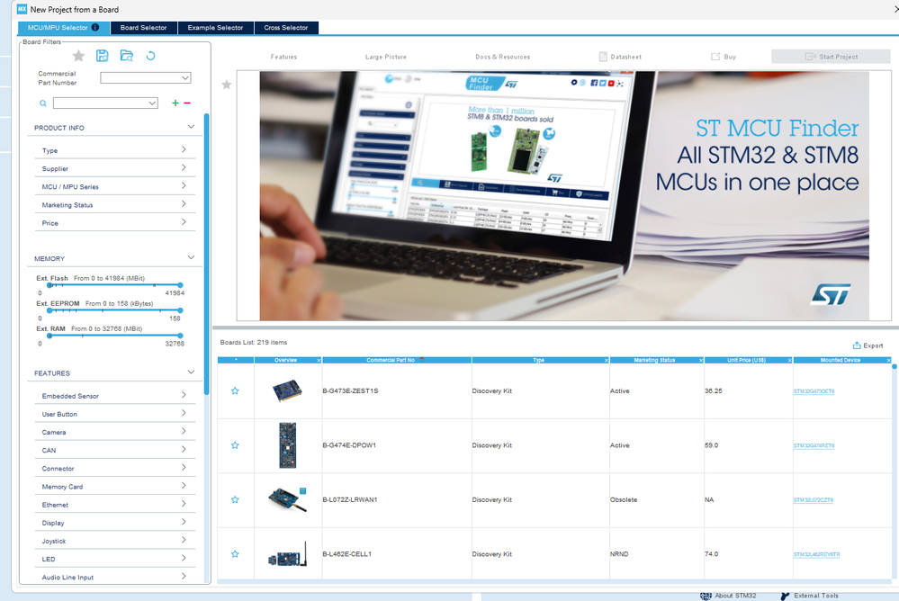

Additionally, when I clicked the "ACCESS to board selector" button, the following loading screen appeared. I believe this is the result of deleting those two folders.

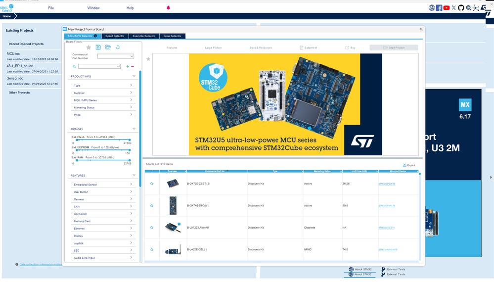

As shown in the above figure, I can still open the board selector by pressing the second button. However, when I click on MCU/MPU Selector on this interface, the pointer still just rotates in circles and the interface remains unchanged.

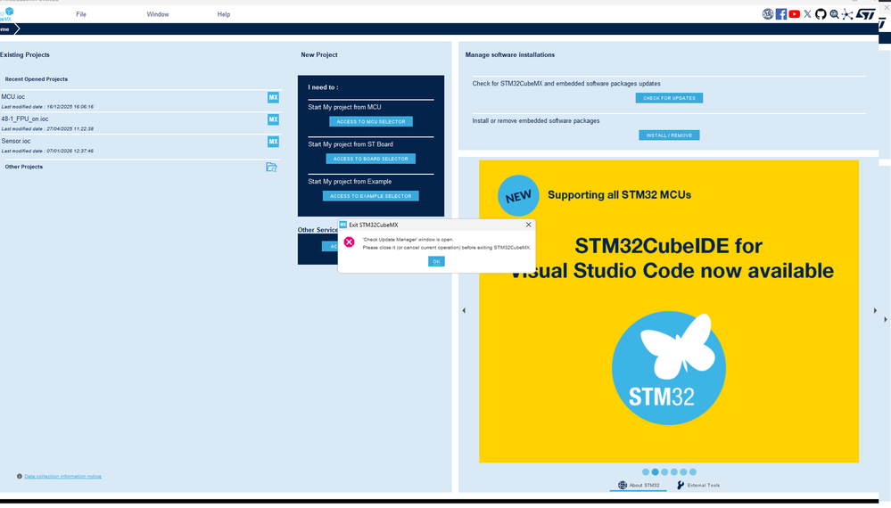

I found that after deleting those two files, if you click on "ACCESS TO MCU SELECTOR", although the interface won't load properly, if you close MX, the following dialog box will appear. I don't know if this is useful. After clicking "OK" for a while, when I closed it again, no such dialog box appeared.

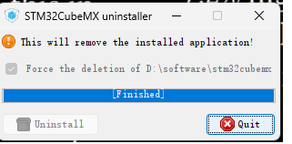

Ok let's try to uninstall MX completely from your machine and reinstall it again .
I will be waiting for your feedback .
THX
Ghofrane
2026-03-10 12:56 AM - edited 2026-03-10 1:01 AM
At the very beginning, I had already tried this method, but even after changing the version, it still didn't work. In fact, I have been using MX for a long time, but recently I suddenly couldn't open the MCU selector.

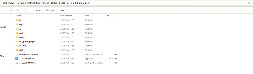

Hello @jungle_bert
1- Close CubeMX .
2- Copy paste this command under MX installation path :
jre\bin\java -Djavax.net.ssl.trustStoreType=WINDOWS-ROOT -jar STM32CubeMX.exe
as shown in this screenshot
STM32CubeMX will start and a console window will display the log output.
3- In STM32CubeMX, open the MCU Selector.
4- Go back to the console window and copy the log messages that appeared when you opened the MCU selector.
THX
