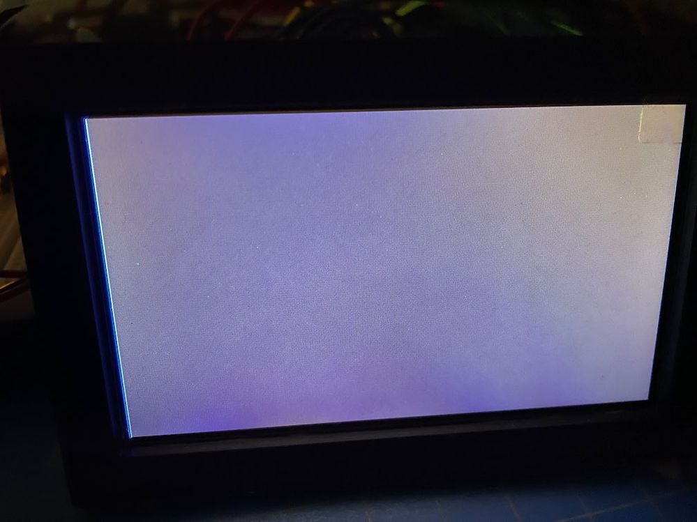

For example I have the following frame buffer data with mostly 0's and only the first value populated with a blue color.
static const uint32_t image_data[480] = {
0x000000ff, 0x00000000, 0x00000000, 0x00000000, 0x00000000, 0x00000000, 0x00000000, 0x00000000, 0x00000000, 0x00000000, 0x00000000, 0x00000000,
0x000000, 0x000000, 0x000000, 0x000000, 0x000000, 0x000000,
}With LTDC PixelFormat set to LTDC_PIXEL_FORMAT_RGB888 - I get the following output on the LCD. A single blue line on the left-most side of the LCD.
I think I can reason about the output but this still raises a question. I was expecting the first value from the frame buffer data to represent a single point on the screen not an entire line. How would I represent a single point if not like this?

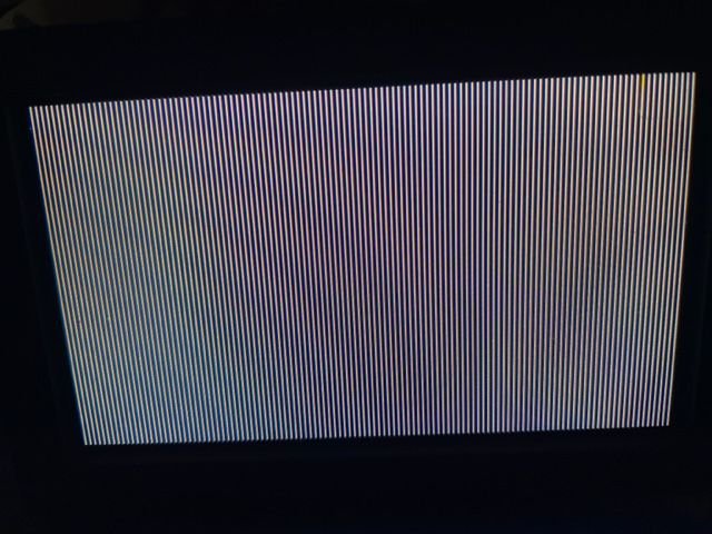

So if each value represents a line on the LCD I modify my frame buffer data to set all values to blue. My expectation is a blue screen.
static const uint32_t image_data_IMG_4138[480] = {
0x000000ff, 0x000000ff, 0x000000ff, 0x000000ff, 0x000000ff, 0x000000ff, 0x000000ff, 0x000000ff, 0x000000ff, 0x000000ff, 0x000000ff, 0x000000ff,
}But the result is actually a consistent pattern of black and white lines. I am guessing there is something I am not understanding about how this frame buffer data is being translated to the LCD. Any hints? I have gone through the LTDC app note AN4861 and the slides for LTDC overview. Any additional material I can read the fix my understanding?
2022-02-22 12:09 PM
The frame buffer can be considered as a 2-dim array of pixels like pixel_t fb[W][H]; It is often accessed as a 1-dim array using fb[y*W+x] instead of fb[y][x]. The result is in both cases at the same offset.
H is the height of the frame buffer, W its width. Both may be greater than the part visible on the screen.
Each pixel has a fixed number of bits for representing red, green, and blue color values. Typical sizes are 32-bit (RGBA, ARGB), 24-bit (RGB, BGR) and 16-bit (5+6+5 or 5+5+5). The order of color channels varies.

2022-02-22 12:23 PM
Okay thanks for the pointer on the 2d array - this definitely makes sense. I will rewrite my frame buffer using a 2d array and uint8_t datatypes. I see where where I might be going wrong here - i am passing 32 bit color values and the LTDC is expecting RGB888.
2022-02-22 12:23 PM
2022-02-22 12:44 PM
Thank you that solved my issue. I'm now seeing expected results.
