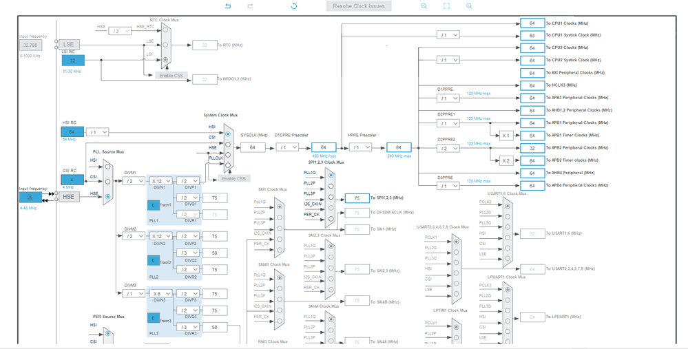

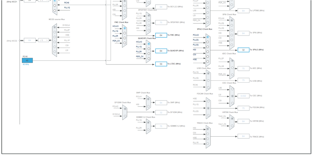

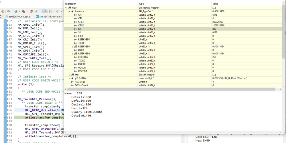

I am using the STM32H745XIH6 board and I have setup SPI using CubeMX in CubeIDE and for some reason, the HAL_SPI_Transmit_DMA never calls the HAL_SPI_TxCpltCallback unless I put a HAL_Delay after the function.

transfer_complete=0;
HAL_SPI_Transmit_DMA(&hspi4, TX_Buffer, sizeof(TX_Buffer));
//HAL_Delay(1); //Needs to be inserted so that transfer_complete = 1
while(transfer_complete==0){};

I even setup my code so that the core stays inside a while loop until all transfer is complete.
Something is wrong but I cannot determine what it is. I wonder if it's the SPI clock?
2023-07-10 12:27 AM
Anyone to shed some light on this issue?
2023-07-10 3:52 AM
Hello @Krautermann,
Could you share DMA Configuration? you will find it in the MSP file.
Did you check EOTIE interrupt is set? TXC is generating the interrupt?
2023-07-10 4:06 AM
Certainly. Please find file attached.
As for EOTIE, I can see it is not set to 1 for some reason while I debug it...
But when I run it, it seems that the HAL_SPI_TxCpltCallback is getting called because I inserted HAL_GPIO_TogglePin(GPIOI, GPIO_PIN_13); inside it and I can see the LED blinking...
